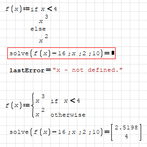

Update of statement:
solve(), roots(), FindRoot() doesn't like if() function.
However, they can solve when cases() used instead of if().

I have diagnosed the symptoms with solve bug.
Made a page about this and tried to explain with detail.

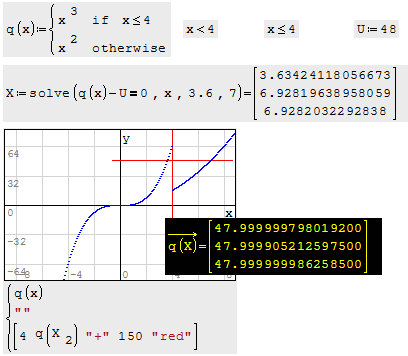

#3 Posted: 6/11/2021 9:21:57 AM
solve(), roots(), FindRoot() doesn't like if statement.
if/else was reported SS 5346.
Davide added if/otherwise SS 6179
Often, the solve bloc is ~ exact, sometimes exact
At worst 4/5 decimals.
Always start true Bolean #≤# ...
often won't complain incomplete #<#
From recollection, only DeBoor needs incomplete.

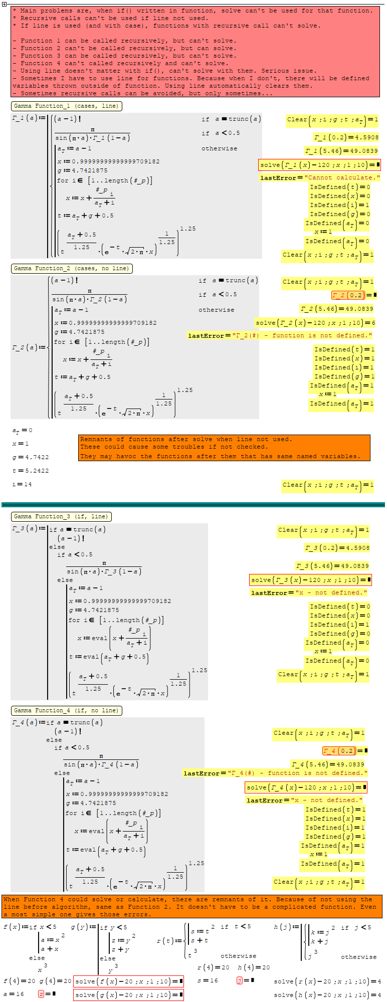

#6 Posted: 6/12/2021 5:12:38 PM
598 likes in 1,380 posts.
There are other bugs too.
otherbugs.sm (13.7 KiB) downloaded 1416 time(s).
