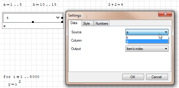

#14 Posted: 8/7/2014 10:24:36 AM
1,443 likes in 2,935 posts.
Here there are different things...
1) Recalculations (evaluations) does not obey "Auto calculation" settings
-> this can be fixed by me with a little bit different design of the plugins, or by Andrey, with a different handling of RequestForEvaluation. Actually I have no ideas about what is the best way (except that I think that if I want to trigger an evaluation, this should be possible), but is not a problem for me to make the fix from the plugin side.
2) Exceptions on opening settings' form.
-> Martin does not experience this issue at all, I have this issues since SMath 0.97.5327 (tested with portable version made from linux package), and this is experienced also by Ioan. This was fixed recompiling the plugins, but the different behavior is really strange.
I've made a clean installation of SMath, used portable versions, used the .NET framework fix tool but nothing changes; I'm not sure if the broken verions are those where the errors are not shown or those where the errors are experienced.
3) Multiple recalculations (evaluation triggered twice)
-> Here seems (correct me if I'm wrong) that here are different behaviors on the machines. Martin does not experience this issue at all, Ioan every times with several plugins (see attachments and comments of SS-192), and me just sometimes (not in my test file but in the Ioan file just with this plugin).
4) No recalculation ( using ( ... CreateTransaction() ) not triggered)
-> This can be seen changing the data source of the region; if the region is updated without closing the form it works, otherwise is broken. This is not experienced at all by Martin, I experience this since SMath 0.97.5327 (again tested on portable version)
P.S. the test on the 0.97.5327 was made just today, previously I have not made deep testings on that version
ioan92 8/7/2014 10:34:00 AM
#15 Posted: 8/7/2014 1:03:22 PM
Point 1 done by plugin design. No more evaluations if AutoRecalc is disabled.
I can do something also for the 4th point but requires more efforts (and will be just a workaround). Points 3 and behavior differences are in the fog, I don't understand where is the issue.

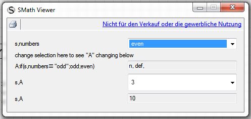

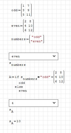

hello guys!
dear Davide Carpi,
as I've been using your very util plugin during
my tesis for the calculation of wooden joints,
I found out about a problem concerning the combined
use along with the Viewer.
It seems to me the once the Viewer loaded the file, all
the settings about the input variables for the comboboxList
are made. In the case, like you see in the example-pictures,
of multiple lists depending on their selection to decide
about the next-ones input, it comes to dificulties concerning
the update process.
The problem still consists with the newest version of SMath.
Is there a way to fix this problem?
I'd be glad aboud any advice of solution!
Thanks a lot!
Greetings,
Eckhard Bräuchler
#20 Posted: 3/9/2016 7:57:22 AM
Confirmed, I'll provide a fix ASAP.
