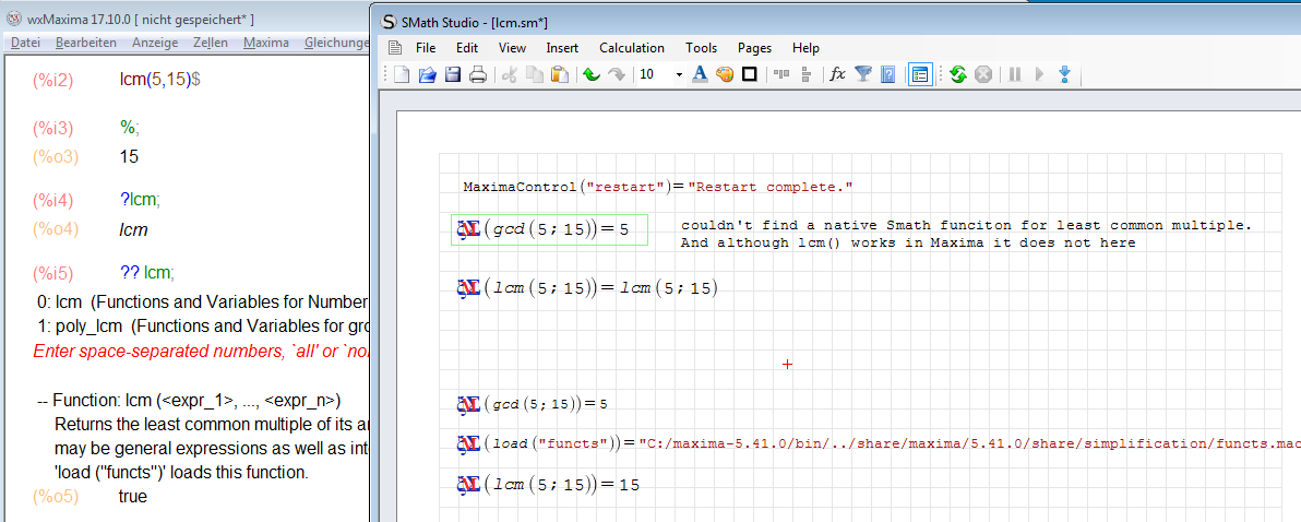

Although lcm() works in Maxima... it won't work for me in Smath using Maxima(lcm())
I'm a noob but researched for hours and am non-the-wiser... Any help is much appreciated.

#2 Posted: 5/22/2018 8:58:17 AM
You need to load the "functs" package in Maxima first. Seems that wxMaxima does that on startup. I could also load this package automatically if required.
You can add this locally to your maxima.xml in the plugin directory (search for this file to find the directory).

#3 Posted: 5/23/2018 4:31:44 AM
Thank you Mr. Kraska...
I found a Japanese page where others had to load it on their Maxima first as well.

Now I suppose I'll need to write a loop in order to use the function with more than two numbers.
Somewhat curious since Maxima has an ezgcd() function which accepts more than two inputs. Anyhow, I will click thanks on your profile Sir.
