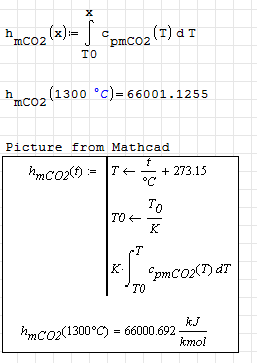

Hi, I have a question about calculation of definite integrals with integral variable in the upper boundary. See example file. Is there any possibility to calculate this integral in Smath?

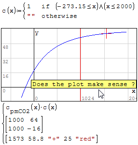

Observe correction in red.
More generally "integrate_0000 [Introduction Scalar]

Many thanks for your help!
