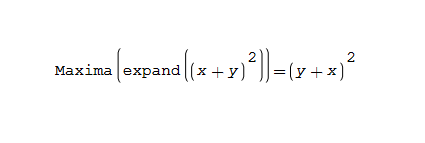

Dose anyone know why using the function expand of maxima dosent work? Thanks

Al usar el comando expand de maxima no ejecuta nada ejemplo
#4 Posted: 5/22/2023 4:15:35 PM
You have to use the functions correctly and you need to set optimization to None, otherwise SMath messes up the returned expression from Maxima.
