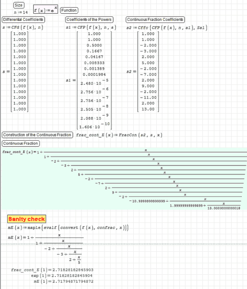

#1 Posted: 2/12/2020 1:04:02 AM
Four examples of Continuous Fractions
Continuous_Fractions_SS7251.sm (79.76 KiB) downloaded 1318 time(s).
Continuous_Fractions_SS6179.sm (76.96 KiB) downloaded 1284 time(s).
Carlos
Carlos

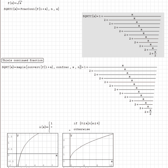

#2 Posted: 2/12/2020 9:17:10 AM
WroteFour examples of Continued Fractions
Thanks Carlos ... works well.
More from Maple ... Jean
Symbolic Convert Parfrac Primary FNCTS.sm (27.81 KiB) downloaded 1260 time(s).

Hola Jean
Thank you very much for your examples, they have helped me to correct
a fault that was presented in the ACOS (X) function, where the value
of "Phi () / 2" was not included.
I have merged all the algorithms in a single function for ease of use.
All the examples you provided work perfectly with the algorithm for
the conversion of function to a continuous function.
SMATH STUDIO VERSION 7251, DOES NOT ACCEPT THE ACOS (X), ASIN (x) AND
ATAN (X) FUNCTIONS FOR MAPLE, GIVING THE "EMPTY STACK" ERROR.
Continuous_Fraction_algorith_SS7251.sm (76.87 KiB) downloaded 1198 time(s).
Continuous_Fraction_algorith_SS6179.sm (77.56 KiB) downloaded 1281 time(s).
Carlos
#4 Posted: 2/12/2020 10:31:16 PM
WroteSMATH STUDIO VERSION 7251, DOES NOT ACCEPT THE ACOS (X), ASIN (x) AND
Maybe Viacheslav can doctor the sick Maple.
Few more in there Carlos ... Jean
Symbolic Convert Parfrac Primary FNCTS.sm (101.16 KiB) downloaded 1300 time(s).
