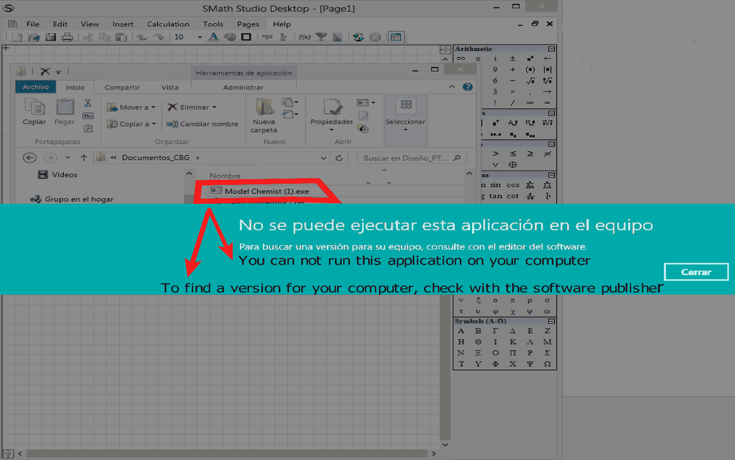

Smath Viewer full version not work any more, the exe file created is not recognize by the computer.
Free version run well, but with print fail in the show variable description, some "show descriptions" are not show.

This is something platform dependent? You can run the same executable in another OS? (win 7/8/8.1)

I try to run the file on another computer with Windows XP , but not recognized.
Files created with Smath Viewer Free , if recognized.

Issues with SMath Viewer Pro confirmed. I'm working to restore it.
