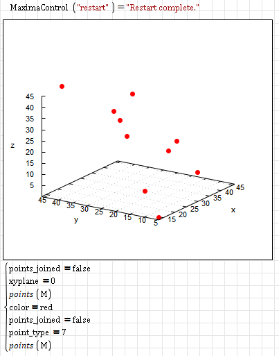

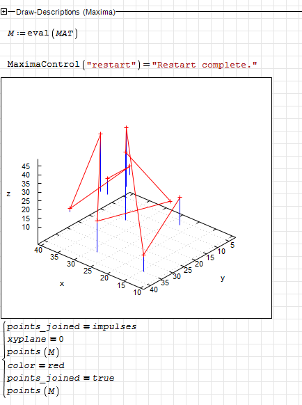

If the plot is sufficiently stable, you can remove the restart command.
You also can remove the first occurances of points_joined and points(). I just used them to demonstrate a selection of options.

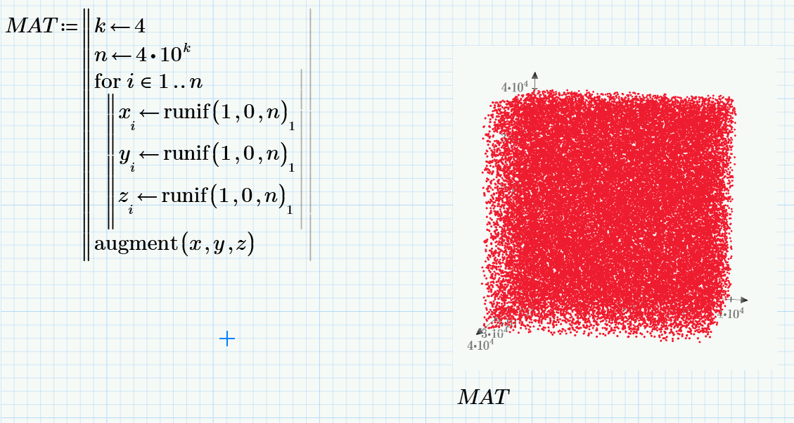

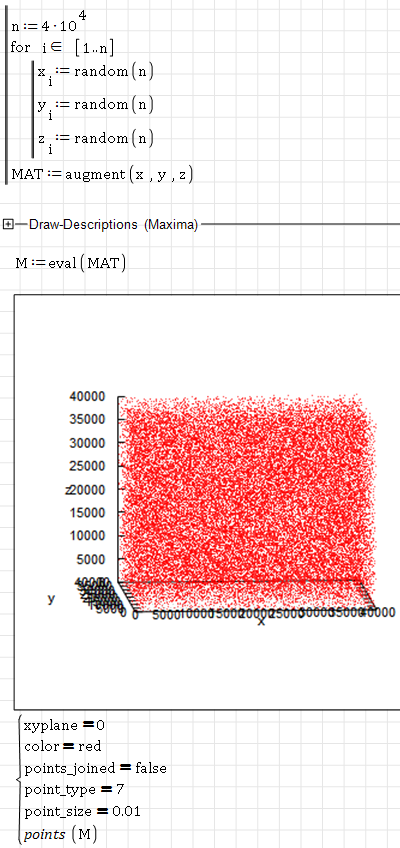

Here, the images:
SMath (40k points):
Mathcad(40k points): (plotting limit of Mathcad)
File:
Scatter plot_Kr-1.sm (152.43 KiB) downloaded 1769 time(s).

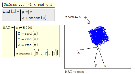

Very difficult to rotate the graphic
No problem to rotate the graphic ... didn't try 5 k.
All native random in CAS are "uniform"
unless specified [Weibull, Normal, Logistic].
We have those in Smath as utilities.
All modules NUMERIC.

There is another option for Maxima based plots in SMath.
You can use the same list of commands as argument list to the function Draw3D(). You can directly put this command into the placeholder of an Image region. This region displays images given by file name. And not really just by chance, the Draw3D() command returns the file name of the generated image. The drawback is that the image is just be scaled upon resizing the region and can't be rotated interactively.
This is sometimes more stable than using the interactive regions.
For further polishing the plot you can basically rely on the official maxima documentation of the draw package. However, not all options are supported by SMath. The german handbook (section 8.1) gives a good overview of what can be done with Maxima and SMath.
Note that pointsize (and possibly other options) don't account for high DPI settings. 0.01 is rarely visible on 4K.

No problem to rotate the 5k graphic
24 Quaternions possible rotations ...
export the preferred angular system.
Would nice to add the cube outline.
Martin: what can you do with that in native SS 6179 ?
Cheers ... Jean.
Rotate 3D TREASURY_4 Quaternions MODULO Matrix.sm (45.96 KiB) downloaded 1743 time(s).

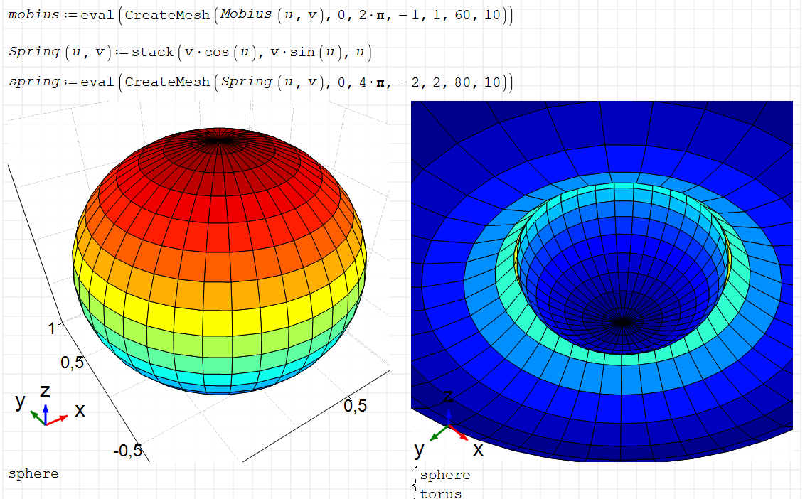

#52 Posted: 8/19/2025 10:32:01 PM
1,555 likes in 1,867 posts.
SMath Studio compatibility History page Changes AI Assistant

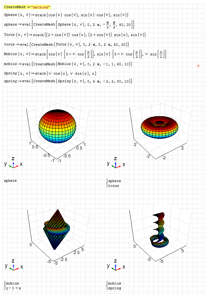

Plugin updated. [BETA]
It's very difficult to improve this plugin. Basically, I started developing it from scratch.
Changes:
- expression parsing has been improved;
- CreateMesh() function has been improved;
- automatic scaling function has been added;
- surface drawing algorithm has been improved;
- added many bugs.
plot3d-examples-draft.sm (11.38 KiB) downloaded 1300 time(s).

#53 Posted: 8/20/2025 8:37:50 AM
Changes:
- improved mouse control;
- temporarily disabled autoscaling;
- added anti-aliasing when drawing.
Edited 8/20/2025 8:39:22 AM
