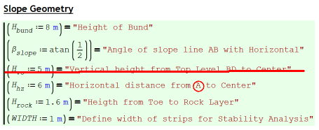

#5 Posted: 9/21/2023 7:45:50 AM
Please make the correction as shown ( replace A with -A in page 3).
Even without this correction, the program will run in most cases, but will give
wrong values for AA for some center cordinates.
This correction is an improvement.
Sorry for the inconvenience.

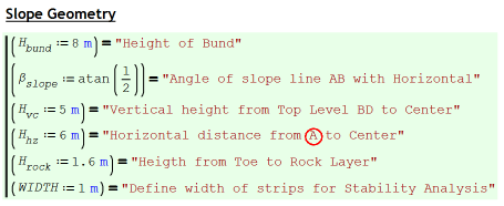

#6 Posted: 10/28/2023 9:32:18 PM
An improved method to my post #5.
I get Wrong Values OR Errors when using the "Findroot()" function for some center cordinates.
This new method mainly uses "root()" function, with few supporting programs.
Slip Circle Intersection Points - TO FORUM.pdf (392.59 KiB) downloaded 973 time(s).
Slip Circle Intersection Points - TO FORUM.sm (247.73 KiB) downloaded 1642 time(s).
