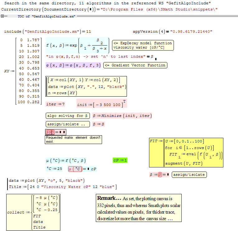

... for best examination: close Smath ... open a virgin session.
This way, as you will download, both will be resident in same session.
Open include to inspect the content, close back.
Open Test UpDated ... F9 to run
Test Updated contents 5 stand alone fit examples.
If it does not work wrt your Smath version ... bug.
Try it ... report ... Jean
Genfit Algo Include.sm (36.12 KiB) downloaded 1277 time(s).
Genfit Algo Include Test UpDated.sm (145.48 KiB) downloaded 1267 time(s).
Hi Jean,
Thanks for your reply!
I tired the .sm file, but it doesn't work well. Meanwhile, the Genfit Algo Include.sm needs rename as GenfitAlgoInclude.sm.
I put the two .sm files in the same location, tSmath_error.pnghen I opened the Test Updated.sm, and pressed F9 to run....the error is shown in the picture.
The information of my Smath is Version 0.99
Looking forward to your feedback, thanks!
[attach]42964

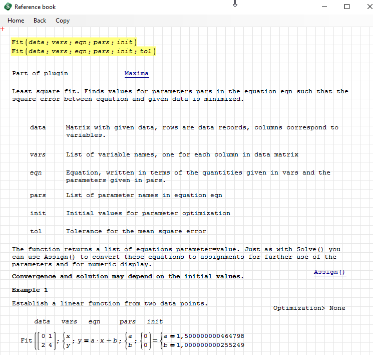

Maxima plugin has the Fit() function, see this post
In the interactive handbook, you find it in the Function Index page.
sergio 1/14/2022 6:15:00 AM
#8 Posted: 1/14/2022 6:56:58 AM
