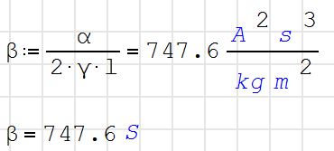

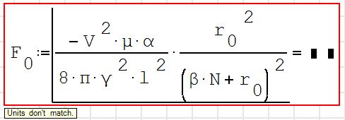

Question 1: In the attached picture, I am getting the error message "Units don't match". I am not sure what this message is telling me. If I have an error in my units, why doesn't SM display all of the units?
Question 2: In the next picture, should SM consolidate the units on its own? When I typed in "beta=", SM then knew the units should be consolidated to S.
Thank you for any help you can offer!
It's a typical error that can happen in sums (and subtractions of course); since here there is only one sum, probably the dimension of beta*N isn't the same of r0 (can't say much more without knowing what are the values behind these variables)
Not a bad idea but in more complex case the units reported might be still meaningless since the error might be thrown in an intermediate calculation (still something that might helps in general)
Probably you are running an older version of SMath Studio, with latest stable I get Siemens as result.

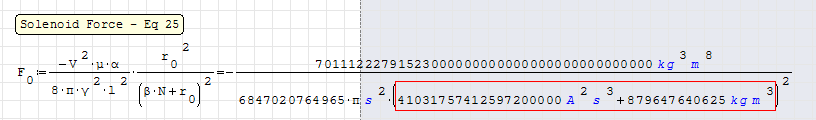

Forget to mention, if you set the optimization of that region to symbolic, you should be able to see the units in the sum part
This is what happens when the region is set to symbolic:
Not what I was expecting!

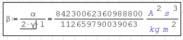

About beta unit, I see both from your screenshot and from your file that you have overridden the output unit, so SMath is doing exactly what you have asked it to do (intentionally or not, but at some point you have written or pasted in the units' placeholder those units).
You can notice it because there isn't the units placeholder after the evaluation symbol (=); select and delete the result units to restore the default behavior (or to change into other units, f.e. you can force the unit to be always 'S)
About the units don't match error, using symbolical evaluation (that was the target of my 2nd post, sorry for not being clear about it before)
Units in the parenthesis are the result of some internal factorization, however r.0 is in inches, beta*N is in Siemens (N is dimensionless), no way that you can sum them as they are.
r.0 is obviously correct since the formula requires a length in the denominator to be correct as final dimension, thus the problem is in beta*N; there might be 2 causes:
  • that's an experimental formula; in this case N is supposed to be a number that multiplied by beta in Siemens produces a length (in inches, in millimeters, ...). Hence you have to adjust "eq 25" multiplying beta*N for the right units in order to produce the expected result;
  • there is an error in that formula (not my field here, I guess is not this case but since I have small knowledge about solenoids I cannot exclude it);

Regarding the first question, I deleted the equation and re-entered it, and....the units came out as S! What I had done originally, I do not know!
Regarding the question on the units error, I have restarted my computer, and now I am getting the same result as you are when selecting optimization/symbolic. I was surprised that the equation gives me an error. I was expecting the program to optimize the numbers and symbols as far as it could go.
I agree with you that there is an error in the equation. I am contacting the author of the paper to see if he can help me understand my results.
