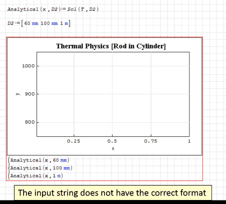

I get the following error: "The input string does not have the correct format" in Smath Studio 98.6606
Carlos
#3 Posted: 2/2/2018 5:59:50 PM
2,343 likes in 4,043 posts.
The same error with earlier versions. I've reproduced it on 0.98.6484.
Seems like locale related issue in the graph plug-in.
