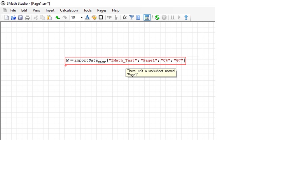

I still don´t get the way how to import xlsx files into SMath files.
It seems, that the xlsx file is found, but there is an error, which sais
my SMath file doesn´t exist.
Would be happy about your help.
Thanks.
G-Tate
#5 Posted: 10/22/2018 12:31:54 PM
Alvaro Diaz Falconi
Alvaro Diaz Falconi
992 likes in 1675 posts.
Hi Tate. The word unavaible "Page1" worksheet isn't about a SMath file, it's about a "Page1" worksheet in the "Excel workbook" named "SMath_Test" (without extension), which I guess that don't exist too (because the name of the Excel file requires the extension, not only the name).
You can see examples about how to use the plugin here:
https://en.smath.info/forum/yaf_postst1860_Xlsx-Import-Export-plugin.aspx
or directly here:
https://en.smath.info/forum/resource.ashx?a=1772&b=2
#6 Posted: 10/22/2018 1:44:28 PM
Stefan Müller
Stefan Müller
0 likes in 45 posts.
Try to add the ending to the filname .xlsx and check if Page1 exists
Seems to be that Page1 is not there in the file
#7 Posted: 10/22/2018 2:11:27 PM
1418 likes in 2873 posts.
If you don't give an extension xlsx is assumed as default; as pointed out by Alvaro and Stefan you have to check if the the worksheet exists in the file
excel workbook = the whole file
excel worksheet = each single tab in the file

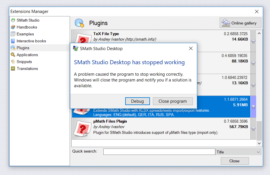

The plugin doesn't work with the latest Smath beta.
It crashes right away during plugin installation:
I tried it in office on Win10 and at home on Win 7,
all the same. I'm using 32-bit SS on 64-bit Windows.
Davide Carpi 10/24/2018 12:52:00 PM
#9 Posted: 10/24/2018 12:54:08 PM
Thank you, confirmed.
Latest release deleted.
#10 Posted: 10/25/2018 10:17:09 AM
Gowand Gravi
Gowand Gravi
0 likes in 22 posts.
Thank you very much guys!
I didnt get, that the second name needs to be the sheet name from the excel workbook.
I just tried it with the smath file name.
I should´ve think about it, that the import anyway goes to the actual smath file.
:d
G-Tate
