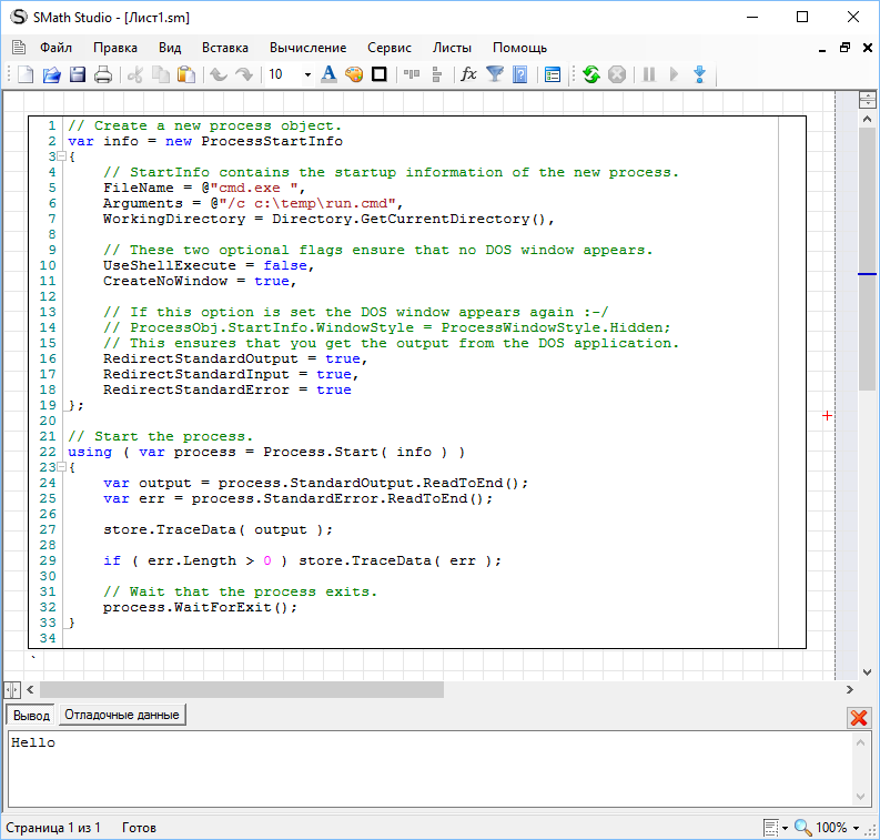

#21 Posted: 7/18/2018 2:46:46 PM
Updated. System.Diagnostics namespace added.
Script.Process.sm (4.45 KiB) downloaded 1701 time(s).
@echo off
echo Hello
exit
// Create a new process object.
var info = new ProcessStartInfo
// StartInfo contains the startup information of the new process.
FileName = @"cmd.exe ",
Arguments = @"/c c:\temp\run.cmd",
WorkingDirectory = Directory.GetCurrentDirectory(),
// These two optional flags ensure that no DOS window appears.
UseShellExecute = false,
CreateNoWindow = true,
// If this option is set the DOS window appears again :-/
// ProcessObj.StartInfo.WindowStyle = ProcessWindowStyle.Hidden;
// This ensures that you get the output from the DOS application.
RedirectStandardOutput = true,
RedirectStandardInput = true,
RedirectStandardError = true
// Start the process.
using ( var process = Process.Start( info ) )
var output = process.StandardOutput.ReadToEnd();
var err = process.StandardError.ReadToEnd();
store.TraceData( output );
if ( err.Length > 0 ) store.TraceData( err );
// Wait that the process exits.
process.WaitForExit();

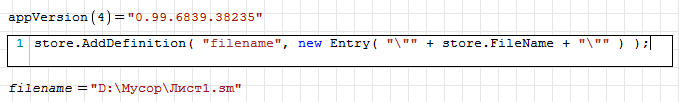

#26 Posted: 10/10/2018 5:36:37 PM
With the last changes in the plugin, this simple script to get the filename of the current worksheet stop working:
The original question, and the script to get the filename its from this post:
https://en.smath.info/forum/yaf_postsm39408_MathcadFileAccess.aspx#post39408
Thanks for your help!
store.AddDefinition( terms[0].Text, new Term[0], new Entry( "\"" + store.FileName + "\"" ) );
#27 Posted: 10/11/2018 3:54:40 AM
#28 Posted: 10/12/2018 12:35:58 PM
Thanks Uni! That change did the trick

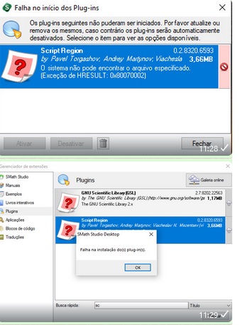

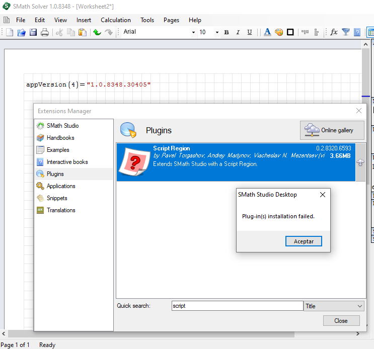

#36 Posted: 11/30/2022 11:46:58 AM
#37 Posted: 12/2/2022 5:06:36 AM
The problem appeared, but its cause is not yet clear. I'll let you know when it's resolved.
#38 Posted: 12/2/2022 1:41:05 PM
Viacheslav,
I was developing an plugin between v1.0 and v0.99 and while my plugin 'worked,' I noticed my region interfered with the graphics (local version, in debug mode), that is the graphics fail to print (and sometimes load) when the region was processed/drawn. I had to reference the version specific *.dlls and that solved my problem. As such, I also noticed that some of the properties/classes changed ever so slightly (not enough to fail a compile, but enough to interfere with operations).
I didn't document this in detail though. I'm just wondering if you have some elements tied to the v0.99- that the v1.00+ no longer implements.
This is an amazing tool; thank you for developing it and I hope you are able to restore its functionality!
