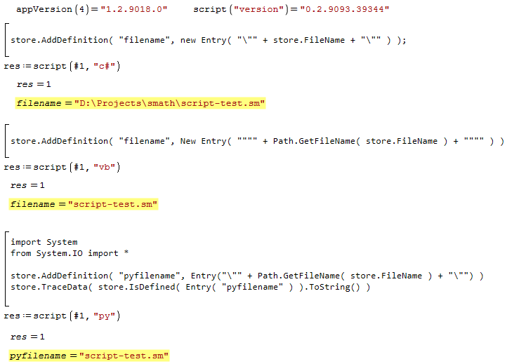

#43 Posted: 11/24/2024 12:21:40 AM
1403 likes in 1708 posts.
As a temporary solution, I decided to add a function that can execute text scripts. Unfortunately, I can't build a working plugin on the server, so for now I'm just showing how it will work.
Oscar Campo 11/24/2024 4:48:00 PM, Alvaro Diaz Falconi 11/25/2024 12:47:00 PM
