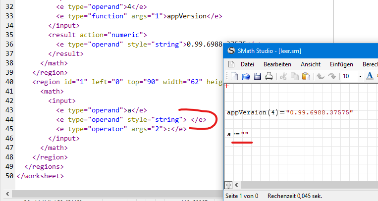

Strings containing only spaces are converted to empty strings when the file is opened and when inserted with copy/paste (include, Post #119):
Andrey Ivashov 2/24/2019 3:37:00 PM
