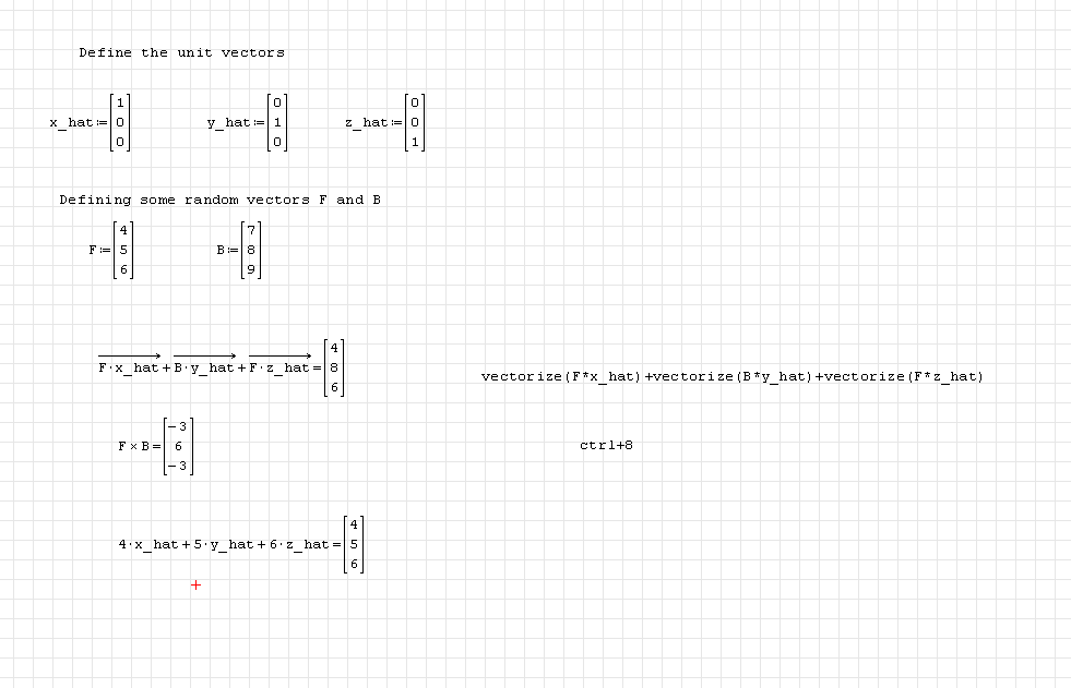

You can perform vector operations. See below. I don't think SMath has a way to put "hats" on the varaibles, but to Jean's point you can just use something from the character map. He used ALT+136 to get e_hat in his example.

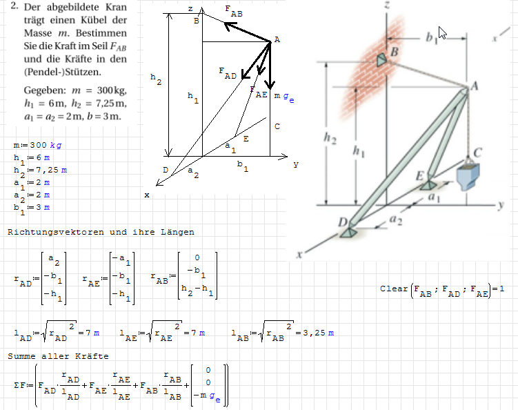

There are some obstacles when trying to do (symbolic) vector algebra and calculus in SMath.
- You can't declare symbols as vectors or matrices (with non-commutative multiply.
- Therefore, symbolic simplifications may fail or produce wrong results.
- The cross product is overly picky about type of arguments, it requires expressions of type
matrix. Even just multiplying by a scalar will break it.
In the attached sheet, the attempt was made to solve some simple static problems using vectors.
If numerical values are given, this works to a certain degree.
The third, symbolic problem required a bit Maxima magic and manual copy and paste in order to get the solution.
There are some pages on matrix/vector operations in the interactive handbook.
13 Gleichgewicht im Raum.sm (196.02 KiB) downloaded 1173 time(s).
