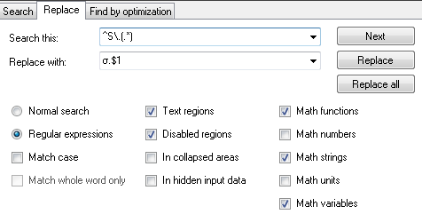

Davide, is there a way / syntax that allows "Text Region Utilities" plugin to substitute some text with a new text containing greek letters?

#11 Posted: 10/13/2021 7:41:58 AM
When I tried search&replace on linux there is that bug again.
Little blank squares are added front and end of variable.
Same cosmetic bug of Numeric UpDown Region.
But this time it effects variable names, not just cosmetic.
That's odd, nothing more than what you set as replacements should be added; I'll investigate it.
You can use regular expressions, like this:
The syntax means:
SEARCH anything that starts (^) with (S) and a subscript (\.) and capture anything after it ((.*)) [parethesis are the "capture" group, the period means "any character" and the asterisk "zero or more times"; BTW the subscript symbol is escaped with \ because otherwise it means "any character" )
REPLACE with sigma (σ) a subscript (.) and the first of the captured strings ($1)
This might be simplified or much more complicated depending on the cases (what is available on the worksheet and the patterns)
More on regular expressions: C# Regular Expressions
A nice tool to test patterns, with live preview: regex101.com

OK Davide, that's more or less the goal I had in mind, I'll need some more study about the proposed notation but you put me on the right path, thank you.
