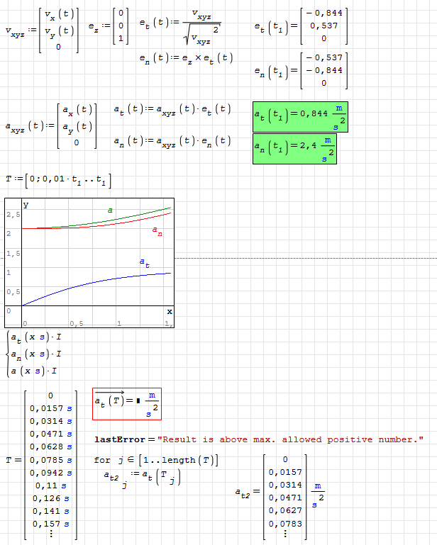

Why does the vectorize operation fail while it seems to be safe to use an explicit loop?
Hi Martin. Because you have just only one function which can't be vectorized: the norme or dot product of vectors.
3 users liked this post
sergio 11/22/2023 4:05:00 AM, Martin Kraska 11/22/2023 4:36:00 AM, ioan92 11/22/2023 4:58:00 AM

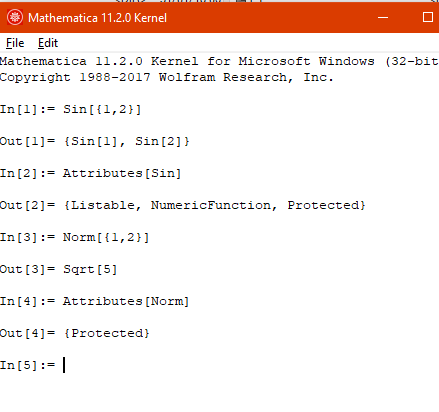

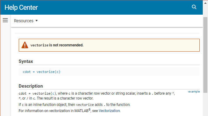

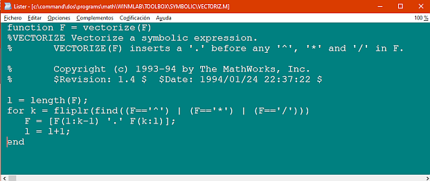

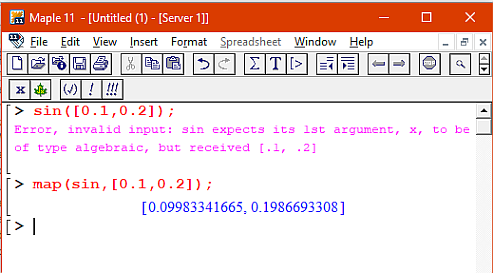

Some notes about how other CAS handle this issue.
Pretty old matlab version, from its symbolic toolbox
The help page from the newest version
So, it looks like they have some issues with automatic vectorization.
With maple it is very uncomfortable, you need to use map even for simple cases
Wolfram's solution is very practical: Function with attribute 'Listable' expands over lists
But for make a table you actually need a loop or the Mathematica's Map function.

Why does the vectorize operation fail while it seems to be safe to use an explicit loop ?
Set the demand in local definition mode ...
new(t):=|a(t)
vectorize and equate
6-2-Bug Doctored.sm (29 KiB) downloaded 74 time(s).

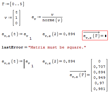

Thanks Alvaro and Jean. Here is a reduced working example.
When a scalar function involves scalar products then it must be defined in a line()-block in order to be vectorize()able.
