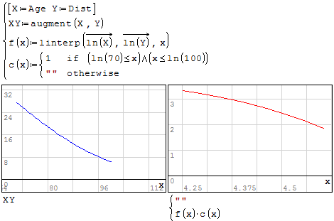

Some thing work like Mathcad and some don't.I need help with the correct syntax for the interpolation function linterp.
Read carefully: linterp, cinterp are 1/1 Mathcad
Smath ainterp has special virtues not found in Mathcad.
Smath linterp, cinterp, ainterp are 1/1 Mathcad as interpolation.
but are 0/1 as scalar functions. In many instances, it is possible
to recast the problem in the form of infinitesimal analysis.
I found no way to render a_c_l interp scalar Mathcad style.
Though, I have the Mathcad code. Don't confuse yourself, a_c_l_interp
they plot on the canvas, i.e: they plot scalar.
scalar is a kernel internal vanishing iterator
Next question: please attach the Smath document.

Oops I meant this way to no success.
Sorry, I downloaded the other one.
Either blue/red will each have an extraordinary good model fit,
for further processing [deriv, int].

... a bit .
RMD CALCULATION (J).sm (26.09 KiB) downloaded 1193 time(s).

Hi. You can do some plots too.
RMD CALCULATION.sm (10.79 KiB) downloaded 1204 time(s).

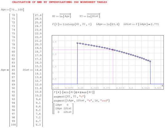

Thanks to all. I was able to find some useful stuff from everyone. Here is where I was headed.
RMD CALCULATION.sm (16.94 KiB) downloaded 1138 time(s).
#14 Posted: 2/15/2019 1:57:46 AM
Sorry, I am just too new to this code to appreciate your input.
Thanks again,
Reg
Hello Reg ... answered in blue

Just a note.
Pay attention to the plot by Alvaro. He uses often neded lele() function (Custom functions plugin) for checking if the value is in a range: Xmin<=x<=Xmax
frapuano 2/15/2019 5:52:00 AM

#17 Posted: 2/15/2019 6:55:22 PM
RegCurry
RegCurry
0 likes in 57 posts.
Is this XY plot new? I find it really helpful.
RMD CALCULATION.sm (18.33 KiB) downloaded 1142 time(s).
#18 Posted: 2/15/2019 10:48:25 PM
Is this XY plot new?I find it really helpful.
Not new, just from applied Smath features as in older SS 6179.
