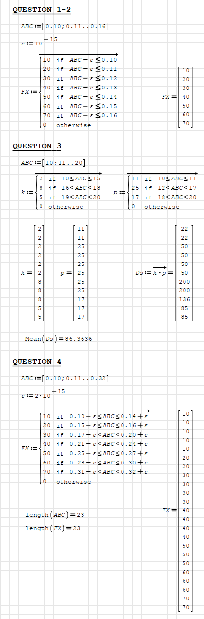

Question 1): smath calculates the numbers in the range with a defined precision (precision error) and therefore the comparison is not respected. You can think of putting a tolerance for comparison as in the file I attach or reason for intervals such as you do for the calculation of "k"
question 1-2(s).sm (7.41 KiB) downloaded 1132 time(s).
Question 2) The average can easily be calculated as in the file I attach or using the "Statistical Tool" plugin
question 3(s).sm (8.71 KiB) downloaded 1066 time(s).
Question 3) As you set it no because if you change the range the comparison does not work. It is possible to better structuring the comparison function

Maybe this worksheet can help you.
As sergio mentioned, you will need statistical tools plug-in for easy average calculation.
And you will need custom functions plug-in for cases(), lelt(), etc.
Those are very essential, so they better be installed.
Floating pointed numbers are stored as divisions in SMath.
They make some difficulties with boolean expressions.
A tolerance could be helpful.
And you can reduce if blocks with cases.
You can also reduce boolean expressions with triple checks.
lele(), lelt(), ltle(), ltlt()
gege(), gegt(), gtge(), gtgt()
questions.sm (16.48 KiB) downloaded 1111 time(s).

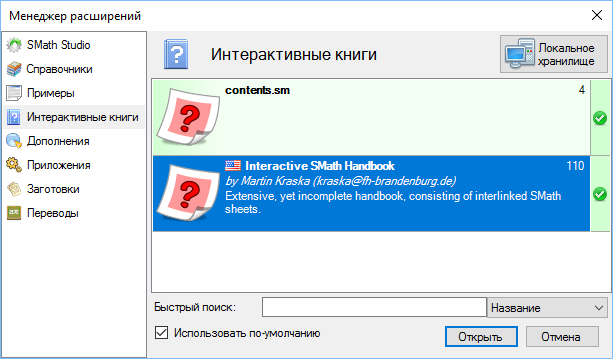

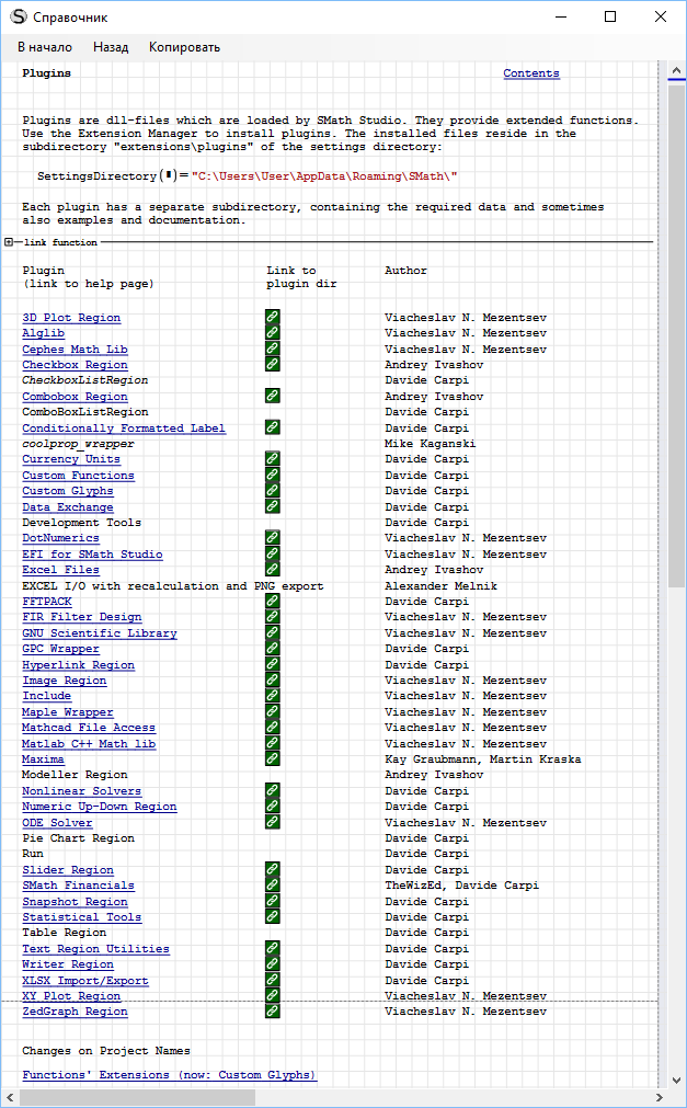

Скажите,а есть ли в программе описание плагинов?

Описание плагинов есть в интерактивном справочнике, который можно установить также как плагины, но из другого раздела.
