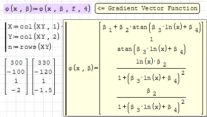

4. Max/Min value in matrix/vector
5. max/min of vector function(s) [example attached]

Do you have that in Mathcad ... hover the pointer on the function.
... forgot to attach the document.
Genfit [HV_WEZ].sm (39.66 KiB) downloaded 1425 time(s).

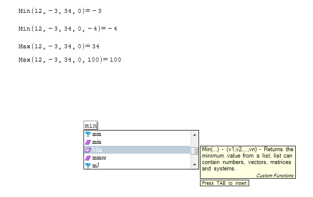

Min() and max() functions ought be overloaded to also accept multiple arguments (same functionality as Mathcad). Or provide an easy way to convert the old mathcad files.
If you install the custom functions plugin, it includes functions that do this.

Example of Min/Max functions:
