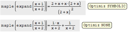

How can I do a symbolic resolution in SMath-Studio?
In mathcad there are: simplify, expand, substitute, etc.
When I solve an equation, I have to use "maple". Can this be done without using it?
[albumimg]1644[/albumimg]
Mathcad to SMath Studio.sm (103 KiB) downloaded 84 time(s).

The built in symbolic engine in SMath leaves much to be desired.
I know the maple plugin has at least some of the functionality you're looking for. Also you'll want to check out the Maxima plugin as that's very useful for solving symbolic equations as well.

Hi Valentino. This is a way.
Mathcad to SMath Studio.sm (102 KiB) downloaded 174 time(s).

Maple and Maxima plugins has symbolic simplify functions.
Unfortunately SMath don't have this features natively.

You can write your own functions to make expand(),simplify() work as if they are implemented.
Don't sure if they will work with complicated function, but they are fine with simple ones.

Alvaro thank you very much, your solution has worked very well for me. I have a question, you use commands like "Collect" and "Opt" but they don't appear in "all my functions"; The program executes the commands but it does not allow me to see their description or know what they are for, are they from a complement?

...I have a question, you use commands like "Collect" and "Opt" but they don't appear in "all my functions"; ...
Opt = Symbolic or Opt = None means that you must to right click over an expression, and choose Optimization / Symbolic or None, not a command.
About collect and other expression they aren't from SMath, but from Maple plugin, which is Maple version 6. So, you must to learn something about it. Maplesoft online help could be very extended: Maple help but you can also read some good manuals like "Aprenda Maple 8 como si estuviera en primero" from Universidad de Navarra (you can google it, it's free). Just a notice: Maple V have several differences about how handle strings and some other things, so if you can't find a good short manual about Maple 6 try only up versions.
