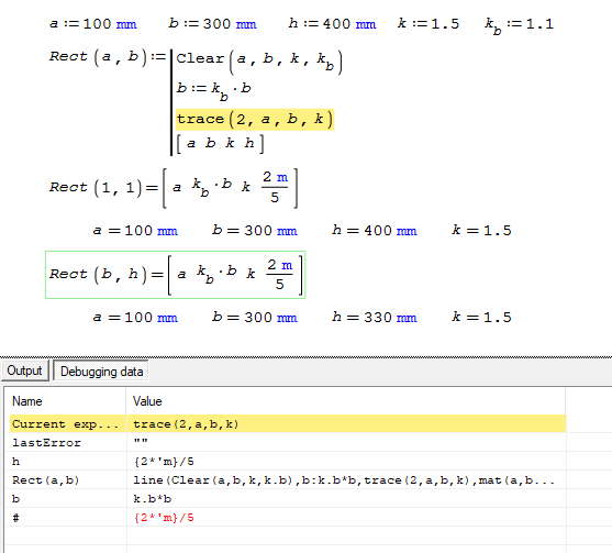

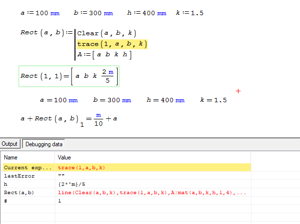

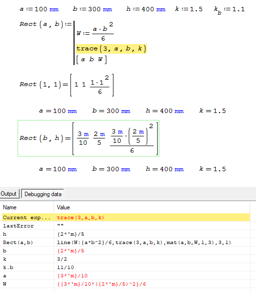

For a better assessment of the subject, I imagined some simple exercises:
Scope-Ioan.sm (57.48 KiB) downloaded 1701 time(s).
These examples show some simple sources "to build the hell".

10. For instance, in my post #4, there is this example:
That drives me nervous. Why the “h” variable was modified; I had never modified it inside the function??? It seems that variables are manipulated “By Reference” and not “By Value”??? Inside the function, I cleared all, including the function’s parameters (as Davide suggested). Of course, the example is a little bit twisted.

#9 Posted: 11/24/2024 10:16:29 PM
I don't think there is a provocation; the program lacks documentation and there are hidden features that might be forgotten or overlap easily.
I have still this around, but seems it is outdated in some parts, since some changes were made along the road: User-defined Functions in SMath Studio (rev.8).sm (293.72 KiB) downloaded 1885 time(s).
Your example has several things inside it, looking by small bits.
I also think a different sealed function would be a good tool to have. About Kenny's layers I understand it, but probably anything "above the canvas" could be safely considered a "superglobal" by the users, and therefore by such sealed function.
- Clear(...)
here you are clearing all variable names. Since a and b are variables passed by the function on the LHS, these are cleared as well. This means all calculations involving these variables are made simbolically.![2024-11-24 15_57_16-SMath Solver - [rect.sm_].png](/en-US/files/Download/825ncV/2024-11-24-15_57_16-SMath-Solver---[rect.sm_].png)
As you can see (now) the result doesn't replace the local variables because SMath recognize that the local a is not the global a (previously it would have been replaced by the global a value once exposed to the canvas). - b:k.b*b
That's not as straightforward as before, but with line() you can pass back variables to the canvas (as official feature, there is some post by Andrey somewhere); if you redefine a LHS variable name inside the line(), this change will be passed back to the canvas, using the input name canvas side.![2024-11-24 15_40_13-SMath Solver - [User-defined Functions in SMath Studio [rev.8].sm].png](/en-US/files/Download/wQHBgs/2024-11-24-15_40_13-SMath-Solver---[User-defined-Functions-in-SMath-Studio-[rev.8].sm].png)
Here it seems the Clear() effect doesn't apply neither on the direct call (e.g. Clear(a,b) has not cleared the inputs b and h) nor in the redefinition (global_h after the function call is not exposed_local_k.b*exposed_local_b but is global_k.b*global_b).![2024-11-24 16_00_55-SMath Solver - [rect.sm].png](/en-US/files/Download/HNKLL2/2024-11-24-16_00_55-SMath-Solver---[rect.sm].png)
Clear() behaviour aside, the point is that inside line() you shouldn't redefine a variable passed as argument by the LHS function.
I think is also bad as practice, since k.b*b it should have another name (b',b*,...) since is another parameter (but I understand the frustration). - twist in variable names (global vs local); this seems it is handled correctly (this is what introduced the change in exposed_local vs global observed in the first point above).

#12 Posted: 11/26/2024 4:29:42 PM
Hi Davide, Martin and Kenny,
All my gratitude for reviewing some aspects of the specific SMath Debugging Process.
Almost all programming languages include debugging procedures. SMath, owing a high transparence and friendly design process, is naturally less indebted to an eventual debugging process. A special case is inside functions.
As about trace() using practice, in the case of a complex application, things are not more so easy. IMHO, an excessive use of debugging risks to kill the major SMath’s singularity – that of simplicity and transparency.
It appears that the very basics of SMath are poorly documented and also not enough retrieved in the Forum. I feel it as a major weakness and a mission to be accomplished.
Looking around some present exchanges, I feel stimulated to observe my naïve use of variables, far from SMath’s native assumptions.
Synthetically, if I’m not wrong, we can say that any variable used on canvas, outside user functions, behaves as global (accessible allover in read/write; including modifiable, with consequences overall in its instances - local or global) over the entire application (including inside user functions).
On the contrarily, inside any function body, all variables which aren’t already used as global (this is identical as being explicitly declared) are only local, without diffusing values into the main application, nor into other users’ functions.
Davide, Martin and Kenny, please correct my assertions if necessarily.
In this context, it appears to me as more logical (?) to “decorate” only the global variable names; this also leads to the idea of using as few as possible global variables (provided, if necessarily, as a precaution, with “decorated” names, instead of an explicit scope declaration).
The local names used inside user functions keep totally the feature of being “sealed” (valid only inside the function) with a full independence of variable content in each function, as long as they do not become “global”. I’m not very sure if a variable used as a function return becomes so “global” (as if declared, “By Reference”)???
A special case is of the applications without user functions. Here the "decorations" are not indicated; all variables are as global.
If what I’ve said here is true and clearly explained to users, there is no more reason to modify the core program.
However, I maintain my proposal on the utility of the creation of a special kind of user function, totally encapsulated.
I wait for some critical reactions and especially proposals about my observations.

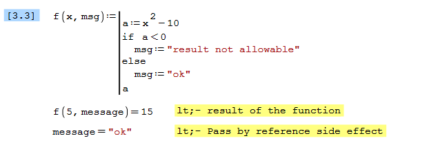

PS:
This example shows that if the parameters of a function are modified inside the function, the global values of parameters will be changed:
what can complicate the use.
That's a suplementarily reason for the use of an encapsulated type of function.

PS:

I don't mind functions using the arguments as output channels (call by reference). E.g. if handling big data, modifications in-place might be more efficient than to create deep copies. If you don't want that to happen, you just don't assign to the formal arguments inside the function.
I am much more concerned about the problem in my above example, where I assign to a variable which is not on the parameter list and have a side effect to the global context. Thus it is not safe to use this function in a context where d has a value. It should not require knowledge about internal naming in the functions implementation to make safe use of a function.
I could perhaps accept that the global context is visible inside the function, but that should be in a strict read-only way.
#14 Posted: 11/27/2024 2:07:08 AM
Thanks for the return.
I agree your observations.
I extended a little my example:
1. I understood that the names in the call line are global names.
2. I copied the input variables as local names, inside the function.
3. Without being alterated inside the function, the input names values seems saved against inner uses.
This seems good news (!?)
4. The input variables copy rest invisibles outside the function.
5. As a principle, any global variable is totally accessible (read/wrote) in all the functions existing on the canvas. Therefor my proposals to give "decorated" names to global variables.
However I'd prefer the special encapsulated function. This leads to less precautions.
Allover, it seems that some strategies are available, once the user is advertised on the basics.
