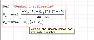

#20 Posted: 2/11/2021 3:32:36 AM
Egidijus
Egidijus
0 likes in 2 posts.
Hello, could somebody help me. I don't understand how to solwe this problem.
