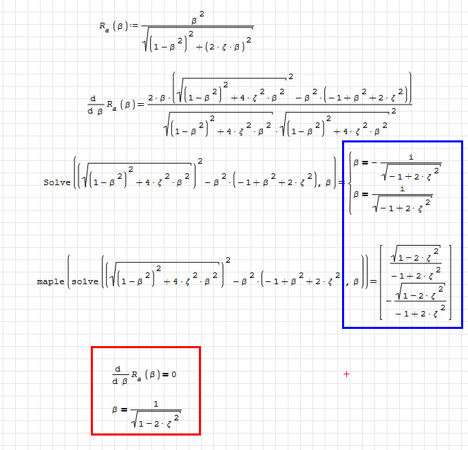

I want to get the real root in symbolic (in red frame) , but solve and maple solve always give me imaginary root (in blue frame).
Edited 9/1/2025 2:15:20 PM

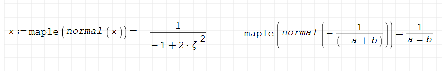

#2 Posted: 9/1/2025 6:09:17 PM
1,555 likes in 1,867 posts.
The answer is correct. The appearance may differ.
The appearance can be normalized, but it doesn't work in this case.

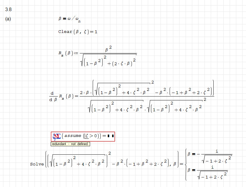

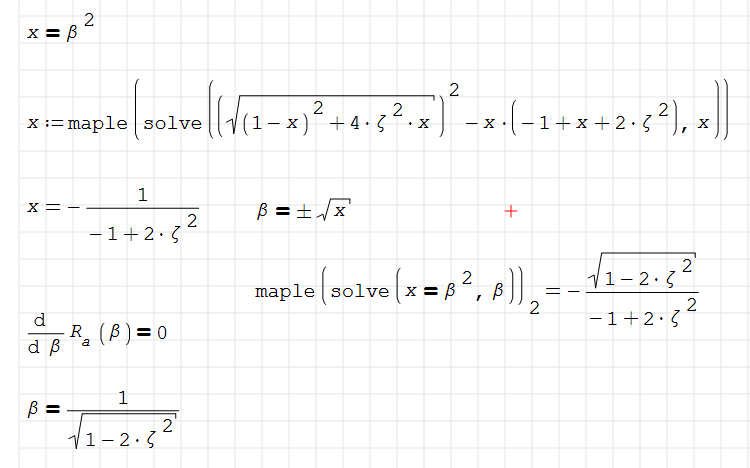

A simple option is force to find a real solution doing:
then...
best,
Oscar

#5 Posted: 9/2/2025 8:40:47 AM
Hi. Using isol:
isol web.sm (223.27 KiB) downloaded 1221 time(s).

#6 Posted: 10/21/2025 12:38:56 PM
netsonicyxf
netsonicyxf
1 likes in 14 posts.
@Oscar Campo
I can't get answer as you show in the pic. Please see the attached.
real root.sm (11.49 KiB) downloaded 828 time(s).

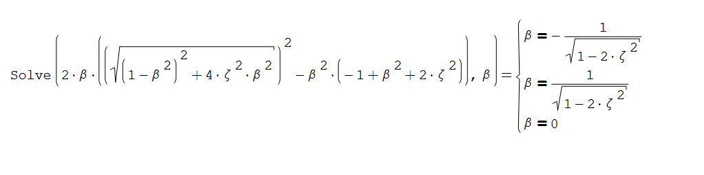

Sometime I do so:
Edited 10/30/2025 8:05:57 PM
