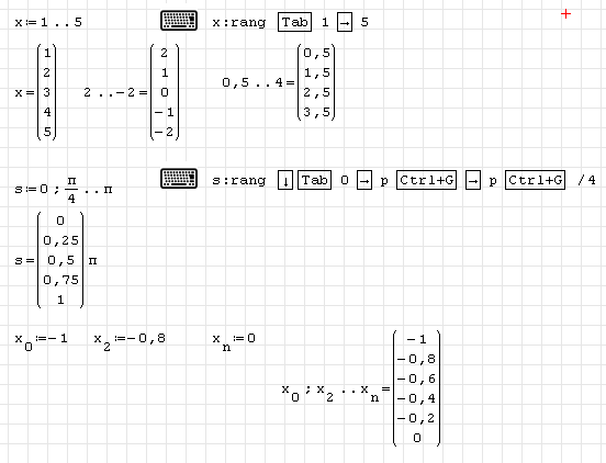

Second, quick question, in the 'for' statement shown above (for i from 1 to n+1) how do you get the two periods (the "to" part of it)? What keys are pressed?

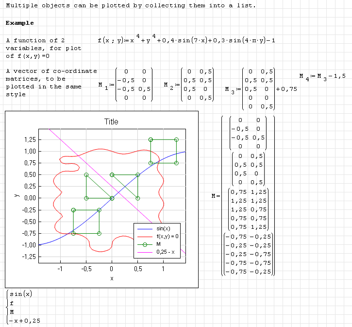

I seem to be having an issue getting this to plot.

What exactly is your issue? As I could see, you just did not change the scale for X-Y plot and therefore did not see your data plotted.
