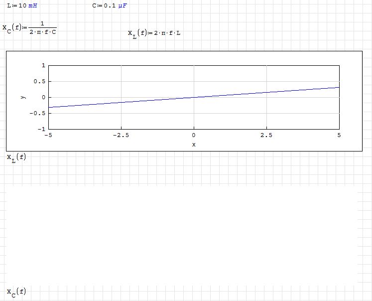

X-Y plot plotting two functions:

#2 Posted: 6/24/2016 9:35:35 PM
Hi Basile. A bug without the file could be hard to interpret.
But, unregarding math or bugs, you're trying to use negative frequencies. Are you sure about what could be represent that? Also, a zero frequency, what is it? Direct current?
Frequencies also are usually represented in a log scale.

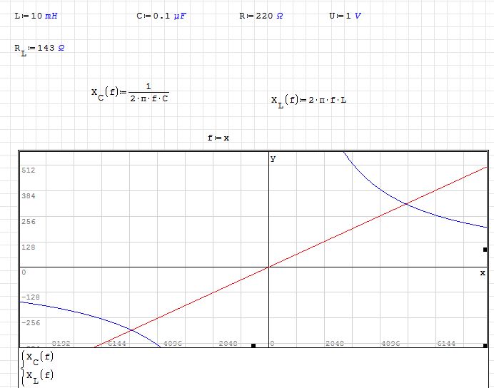

#3 Posted: 6/24/2016 10:42:36 PM
Basile
Basile
8 likes in 172 posts.
Alvaro,
All you say about the physics of the problem, you are right.
But look the mathematics, just plotting a function.
Look above, the X.L(f) plots fine.
Similarly plots fine if I use the Plot-2D.
Basile
#4 Posted: 6/24/2016 11:19:22 PM
Hi Basile. You discover a couple of nice and unwanted visual special effects in blue. I know near nothing about smath plugins, and can't help about them.

#7 Posted: 6/26/2016 7:51:00 AM
1,443 likes in 2,935 posts.
Seems the issue is related to negative infinity
#8 Posted: 6/26/2016 9:18:34 AM
Basile,
What you did is no not correct: You copied the L
plot and put in it the C plot with the same L scales.
So, the C plot flies in the blue. Someting like this:
If you photograph a mouse and an elephant in the same
bed, you won't see both. If you adjust for elephant,
the mouse will be a dot pretty hard to isolate and
enlarge unless you have zillions of MP resolution ...
#9 Posted: 6/26/2016 9:27:34 AM
Forum Basile Plot.sm (4.95 KiB) downloaded 1226 time(s).
#10 Posted: 6/26/2016 2:31:03 PM
Basile
Basile
Jean,
Yes, it works with the Plot 2D.
The problem is with the X-Y plot. It disappears and freezes the instance of Smath!
As pointed by Davide a possible problem with minus infinity?
Basile
#11 Posted: 6/26/2016 4:05:08 PM
NO => Not as you think. X_Y is not an autoplot, it is a plot range.
If you plot sin(x) it falls in its default XY ranges OK. Otherwise
you have to range both directions. X_Y does not supports few things:
1. It does not plot x. It does not understand that 'x' is implicit
of 'x' = "1*x" neither implicit of 'x' = 'x+0'
2. It supports some common Engineering ranges 1*e ±3 [per say]
but will crash Smath instance if you want to range 1*e ± -15
X_Y is lovely in many projects but not in others.

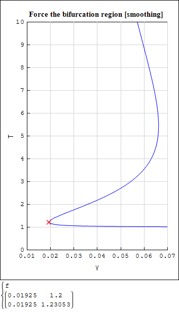

#12 Posted: 6/29/2016 1:02:35 PM
Fridel Selitsky
Fridel Selitsky
520 likes in 451 posts.
By increasing the limit values of the function  the graph does not
pass through a pivotal point
Bug.sm (8.2 KiB) downloaded 1259 time(s).
#13 Posted: 6/29/2016 2:31:53 PM
That's right but not a bug. Just that above the Y magnitude 45,
the canvas misses some points in the critial region.
More: does not fill the circle, plots x instead of +
X_Y Plot wisely.sm (11.2 KiB) downloaded 1281 time(s).
Fridel Selitsky 6/29/2016 2:37:00 PM
#14 Posted: 6/29/2016 2:38:02 PM
