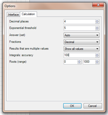

Probably you have an high range in your settings (try Tools -> Calculation -> Roots (range))
I get your result with -1000 .. 1000
Simply use a smaller or better range (f.e. in your example you can set the bottom range to 0)

#3 Posted: 11/22/2014 3:07:20 AM
:d Thanx
That solved my problem - I set the roots (range) to -500;500 and the result is now right.
The strange thing is: If I set the range to -1000;1000 and do a solve(sqrt(x)=5;x), the result is right.
Is there any explanation I could tell my users?

#4 Posted: 11/22/2014 3:36:42 AM
WroteThe strange thing is: If I set the range to -1000;1000 and do a solve(sqrt(x)=5;x), the result is right.
The result only looks right, when showing only the default 4 decimal digits. If you increase precision, you will see the same 25,0000013034682 result.
The solver makes limited number of attempts (by an algorithm) in the specified range; it stops when subsequent attempts give close results (or when it decides that it failed). "Close" is measured relative to the range size. Some ranges may happen to give sequences that result in presize (in terms of machine representation) results; however, generally only some approximation is achieved.
