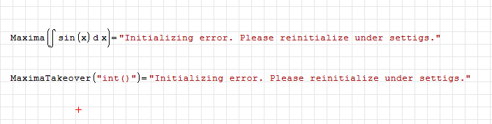

Hello.

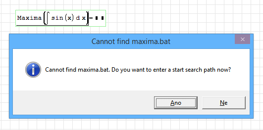

Maxima does not work in my SMath. What is wrong?
First use of Maxima function asks me for a path to maxima.bat, but there does not follow any dialog for to find the file...
Any maxima function gets an error. See images.
Thanks for answer
Regards Olik

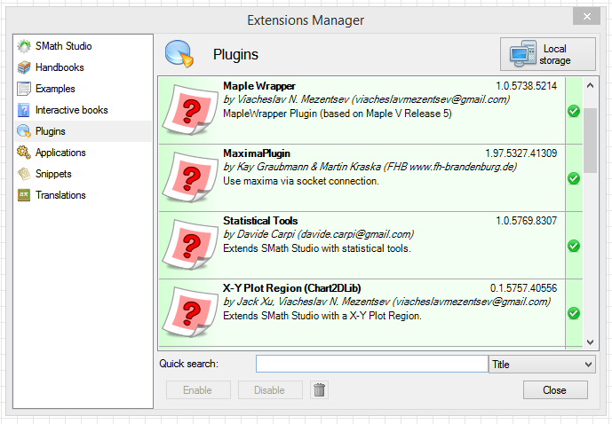

[1] Maxima is not a standard plugin.
- I do not know how it got in my comp at home (with some sample, I suppose).
But it si not in the other comp, in my office.
[2] It is not easy to install correctly the plugin ...
That is - I think - my problem;
[3] Please, where can I find
HOW TO INSTALL THE PLUGIN CORRECTLY?
Is it designated only for a portable version?
Thanks, Olik

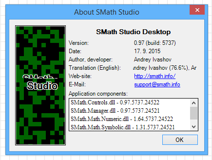

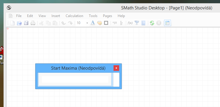

Hello.
I downloaded and unpacked the portable version
(2014 11 16 SMath and Maxima\Maxima-5.34.1). I tried to set the path to maxima.bat or to execute a maxima command
( MaximaControl ("cleanup" ) = ).
All I got is a dialog "Maxima does not answer" & the rotating cursor... Do I have to setup something more?
Maxima looks so interesting, but I am always not able to run it...
Regards Olik

You should not need to setup anything, even not setting a path to maxima. Did you try running the unmodified and untouched portable version? Just try the interactive handbook (question mark button in the toolbar) and find some Maxima stuff there.
I am not aware of what might happen with win8 or win10. Never tried that, but no complaints from my students so far...

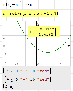

#8 Posted: 12/12/2015 1:35:37 AM
Your function has root = 1
Always plot before solving
"solve" for a single function is implicit of solving for the roots
so, your solve block is ill conditionned.
"Assign" ... Assign what ?
here is an example of good use.

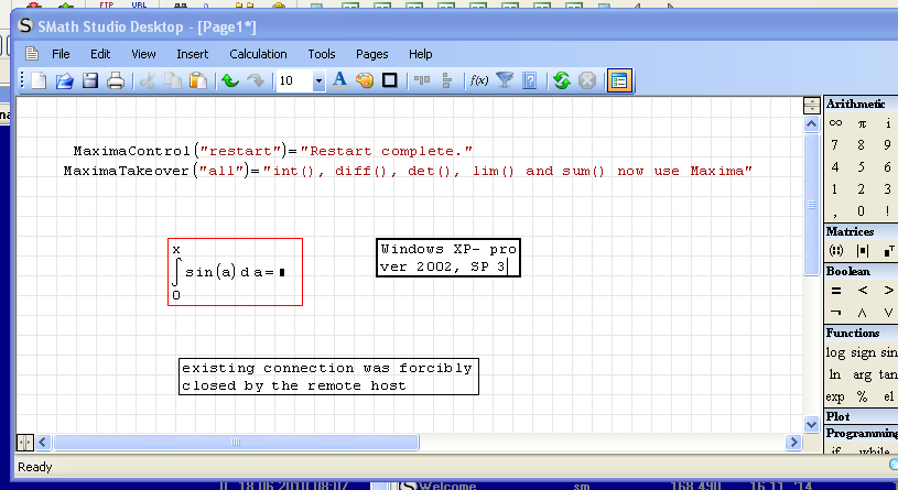

Hello.
I tried to run portable with maxima on w7, w8 -- collapsed
and on w xp -- I could Takeover, but I could not evaluate int() function.
Sorry. I solved my problem using maple() function. It is not so nice ...
regards, Olik

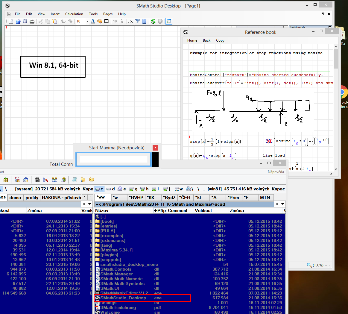

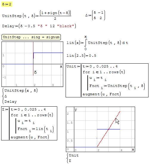

#10 Posted: 12/12/2015 7:12:07 PM
Honestly: I wonder why some Smath users pesist with Maxima ?
done XP [SP 3], just Smath

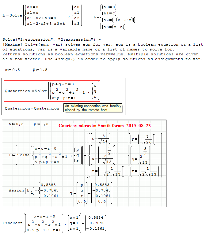

#15 Posted: 11/3/2016 11:16:18 AM
Sorry. with maple it works. Smath doesn't load the Maxima Plug-In on my Windows10 system when I use Solve(). If i assign Smath the Maxima.bat i get an error report.
If you are new to a CAS [Computer Algebra System] like Smath or Mathcad per say,
you will suffer getting used to what works simply and what does not work "simply".
The Smath [Maxima] "Solve" is recurrent/circular/never been answered properly.
My conclusion from observation is that Smath designers have permission to access
"Maxima Solve", but that permission is not distributed with the public release
of Smath ... "An existing connection was forcibly closed by the remote host"
!!!!! forcibly !!!!!
In this snippet, Martin Kraska had permission for the 'Quaternion' but not me "forcibly"
For me, it does Solve the top system as a "Maxima gratification" but then forcibly rejected. In other words "not public". Alternately, you can use "FindRoot".
Be careful: setup the system in lexicographic order. Quaternion has two expansions
because of ^2. FindRoot is numeric only and you don't know which one is which.
FindRoot is very dependent of the initials.
Solve at "Maxima home" does probably solve symbolic for $ then zap Smath.
AFAIK, Mathcad Prime use "Maxima" for $ and probably solves "Quaternion" properly.
If not: Mathcad Prime => piece of crap vs Mathcad mathsoft.
