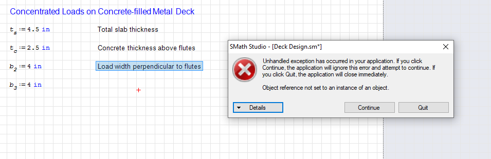

#6 Posted: 12/29/2020 11:30:25 AM
Jason McCool
Jason McCool
9 likes in 78 posts.
I'm getting an unhandled exception error when copying text regions by highlighting an existing text region and using the Control key + mouse to copy it. It does continue without crashing, and I can apparently copy by highlighting and using Ctrl-C and Ctrl-V, or by using the buttons on the menu bar. So far it only seems to be the Ctrl + mouse method of copying that used to work and doesn't in this build. Formulas still can be copied and pasted that way without error.
Thanks,
Jason
Andrey Ivashov 12/29/2020 4:18:00 PM
#7 Posted: 12/29/2020 4:19:33 PM
2273 likes in 3737 posts.
Thank you!
The reason of this error is the same as it is in the issue [USERLINK]Razonar[/USERLINK] mentioned above. Fixed now.
Jason McCool 12/29/2020 4:22:00 PM
