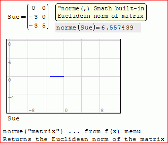

#11 Posted: 2/15/2016 12:00:57 PM
Hello, kernel.
So, I understand that you will kiss your girl friend if
you walk the right East/North distance while she walks a
lesser diagonal distance. What happens if both of you
end in the Pacific Ocean ?
More interesting: for spot testing of the camara objective
you will have to check the symmetry of the spot...
There is more about applying a correction matrix wrt the
mapping of the sensors.... Maybe a RemToDo in Smath.
More stuff in the attached.
jean
Utilities Matrix [Times, Dia, Mirror,Euclid].sm (30.86 KiB) downloaded 1143 time(s).
