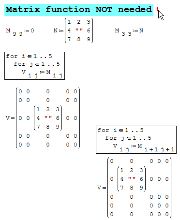

#2 Posted: 10/6/2016 12:33:21 PM
983 likes in 6866 posts.
I understand the code you are proposing, but wonder if useful.
It would be local anyway, which Smath has it already.

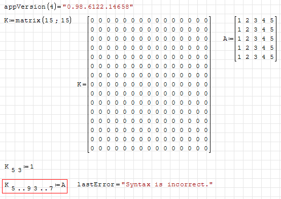

#5 Posted: 1/16/2018 1:49:04 AM
2273 likes in 3737 posts.
You can improve your "syntactic sugar" even more practical, Mathcad style.
i:=1..n
j:=1..n
M[i,j :=Mandelbrot
Started implementation of this feature in order to improve compatibility with other software:
Best regards, Andrey Ivashov.
4 users liked this post
Martin Kraska 1/16/2018 4:04:00 AM, frapuano 1/16/2018 4:35:00 AM, Davide Carpi 1/16/2018 5:31:00 AM, Radovan Omorjan 1/16/2018 2:22:00 PM
#6 Posted: 1/16/2018 4:06:53 AM
1225 likes in 2151 posts.
Besides compatiblity to "other software" this will improve the readibility in comparison to the vectorize operator, which is not really clear to third party users.
