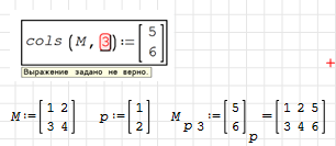

And what about the last Mathcad operator?

There is no desire to repeat the functionality of Mathcad completely. This is a different program and it has its own users. So far, no such operator has been required.

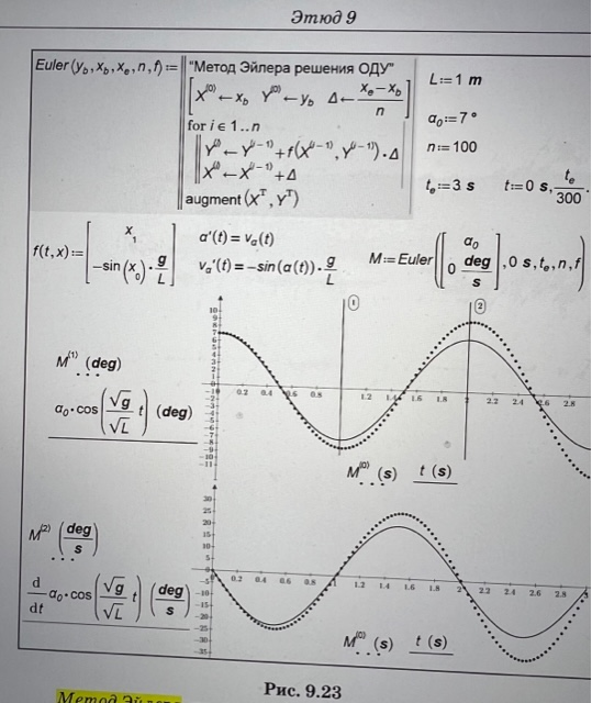

У меня есть целое практическое видео, где показывается метод Эйлера в SMath Studio. Причём здесь last?

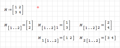

... And what about the last Mathcad operator?
Matrix handling in SMath is more similar to Matlab than Mathcad.
I need

Euler.sm (26.06 KiB) downloaded 1507 time(s).
