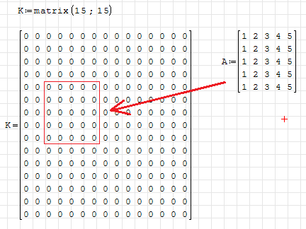

Helo Everyone!
I have one question: imagine the matrix of size 15x15 filled with zeros. I want to put smaller matrix 5x5 to the bigger one but from column 2 to 6 and to rows 4 to 8. How can I do this?

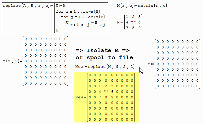

#6 Опубликовано: 05.10.2016 13:00:12
#7 Опубликовано: 05.10.2016 13:02:36
... next: try NOT to isolate "M"

#9 Опубликовано: 05.10.2016 23:32:45
Please note that SMath's count of rows/columns starts from 1, not 0 (as your question implied).
Quite right:
Davide "merge" is Smath style based on index ORIGIN = 1
Jean "replace" is Mathcad style based on default ORIGIN = 0
