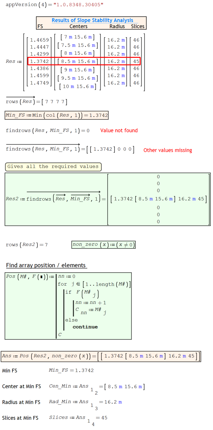

I came across a problem in the use of findrows() function when applied to a nested array.
The nested array is the result of a Slope Stability Analysis example.
Sufficient explanatory notes included.
However, I was able to get required values by some manipulations as shown.
Is there a better method ?

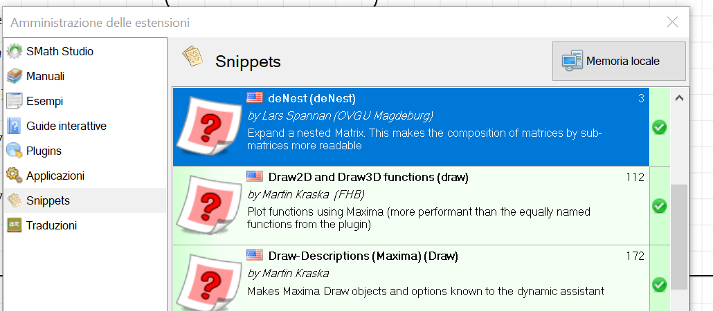

using the deNest snippet (found in the tools).
Показать спойлер

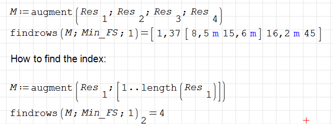

I'd perhaps just join the columns by augment() and then apply findrows().
Findrows Problem_Kr.sm (23 КиБ) скачан 74 раз(а).

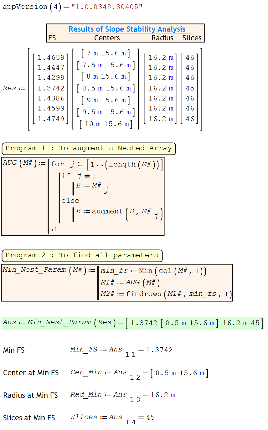

A revised program, based on mkraska's solution.
Findrows Solved.sm (15 КиБ) скачан 73 раз(а).
