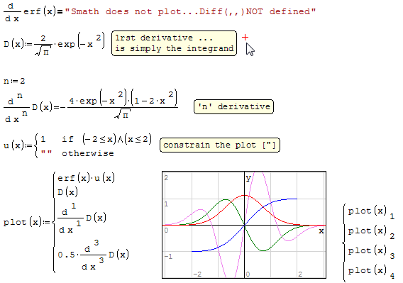

An attemp to use Leibnitz differential notation.
differentials.sm (53 КиБ) скачан 97 раз(а).
differentials.pdf (93 КиБ) скачан 107 раз(а).

#4 Опубликовано: 05.12.2019 14:33:17
Maybe there are more reluctant functions ?
