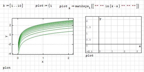

When a parametric function is stacked with sys() nested matrix or matrices, it doesn't plot.
It is plotting if they are at same level in sys(), plot1 example.
When there is no parametric function, there is no problem, plot3 example.
Otherwise 2D plot is not capable to execute.
XY-Plot has no issues at all.
plotbug.sm (23,75 КиБ) скачан 1667 раз(а).

Once in general the plot regions (built-in, X-Y Plot) can handle nested lists, it is fair to call the failure to do so in special cases a bug
Parsing the input data is a rather difficult part of such components. A dedicated designer is needed to cover commonly used use cases while avoiding ambiguity.
Some of the examples shown here were not originally intended to be used, but are artifacts of a particular implementation. Increasing complexity of input variants requires careful testing of compatibility with old behavior. This is especially true for nested structures.
For X-Y Plot component, I chose some use cases that I indicated in the first post and, when updating, I constantly checked that the specified examples worked correctly.
