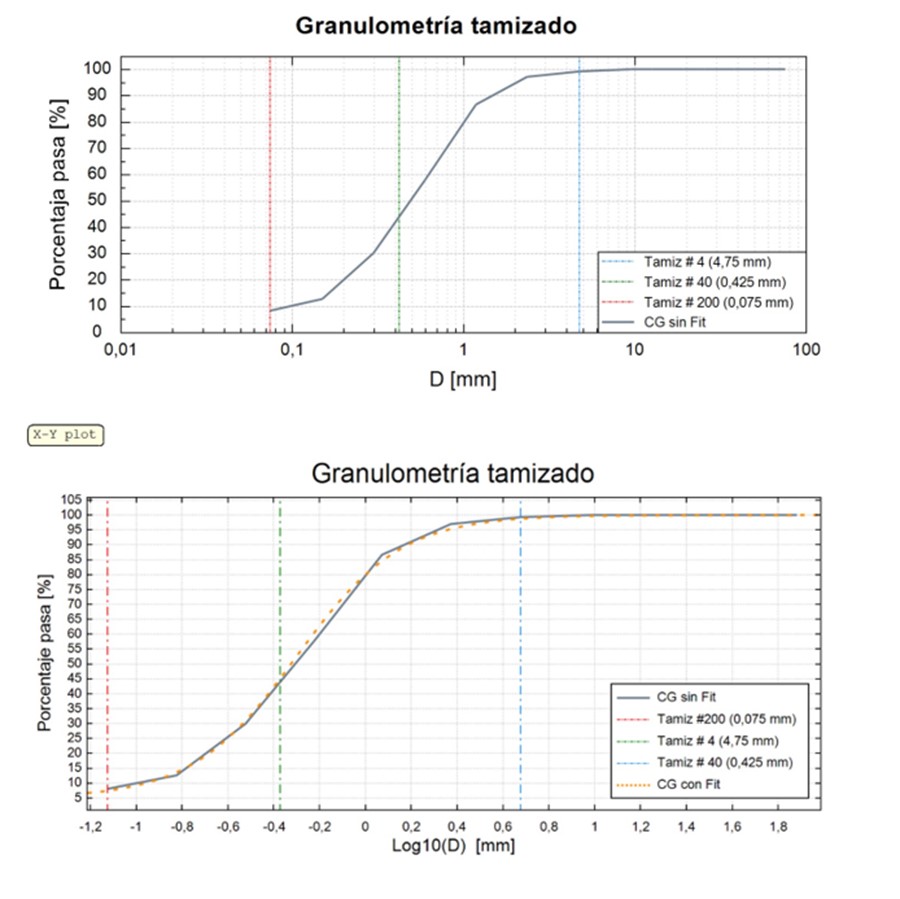

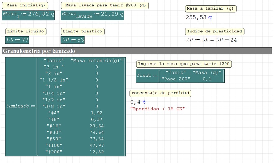

Attached is a spreadsheet to classify the soil according to USCS and the granulometric curve is plotted by sieving.

WroteFit & explorer ... Jean
USCS fit Granulometry.sm (21,61 КиБ) скачан 1678 раз(а).
Thank you so much,
I added the logistic sigmoid function you made to the initial code and it compare with and without the fit. In addition to the initial curve, I graphed it using the Zed Graph, where it can be better appreciated using a semilogx graph
USCS-fit-Granulometry.sm (175,97 КиБ) скачан 1576 раз(а).
