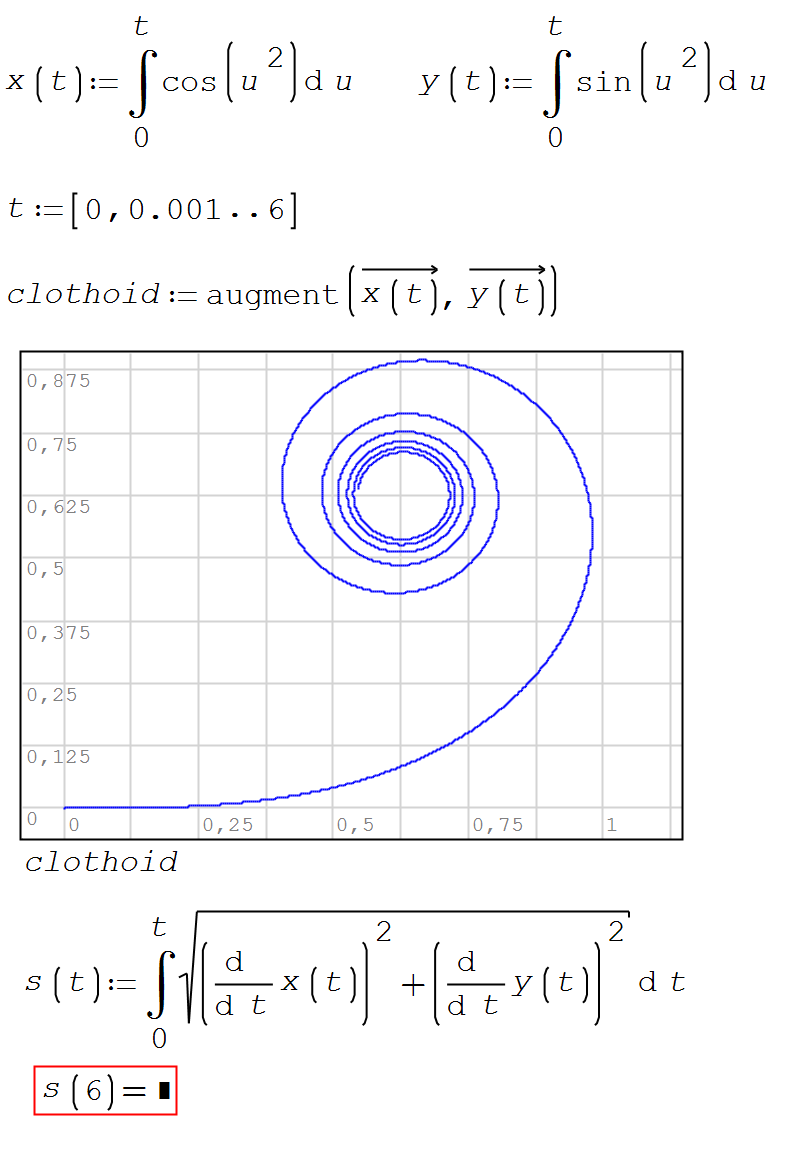

Continuing the topic
https://en.smath.com/forum/yaf_postst23677_Why-I-have-no.aspx
This is a clothoid or Euler spiral (https://en.wikipedia.org/wiki/Euler_spiral). It is said about it that its curvature depends linearly on its length. How to show it in SMath?
Spiral-Euler.sm (5,75 КиБ) скачан 1380 раз(а).

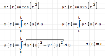

#4 Опубликовано: 27.09.2023 19:06:44
How to show it in SMath ?
Maths Clothoid Copy.sm (53,73 КиБ) скачан 1384 раз(а).
Valery Ochkov 28.09.2023 01:28:00

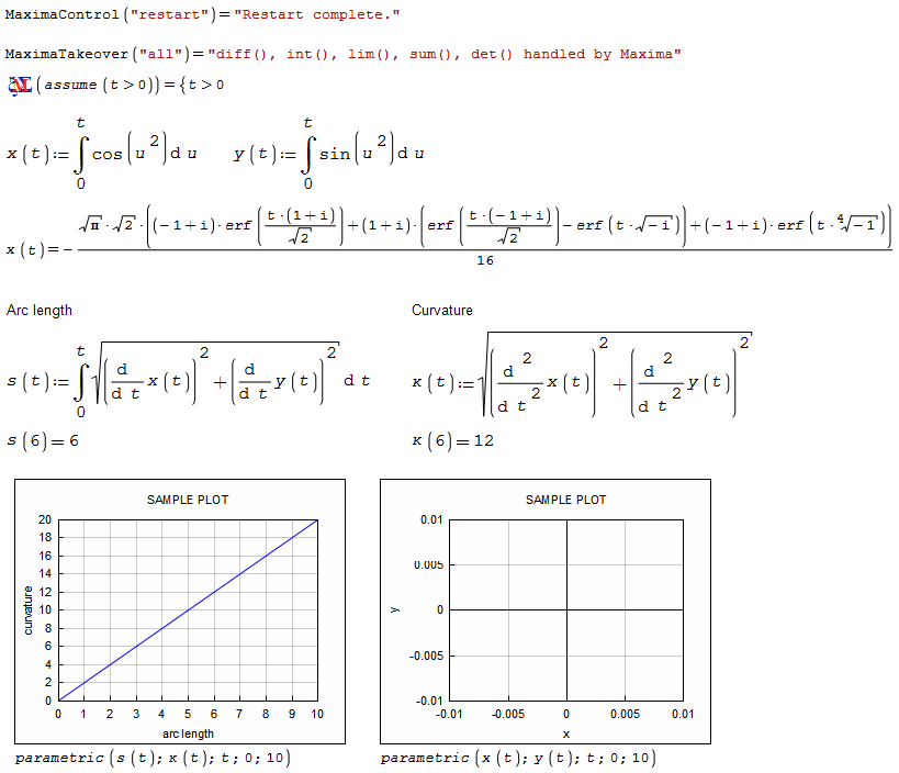

#7 Опубликовано: 28.09.2023 04:19:07
For the attached sheet to work, the Statistical Tools plugin must be deactivated, because it's erf() shadows the Maxima function erf().
The curvature-arclength plot is easily done, yet the xy plot of the curve itself fails because Maxima isn't able to evaluate the functions x(t) and y(t).
Yet, it is not proof of linearity, just an illustration.
Spiral-Euler_Kr.sm (34,32 КиБ) скачан 1380 раз(а).
Oscar Campo 28.09.2023 09:58:00, Valery Ochkov 28.09.2023 04:22:00
