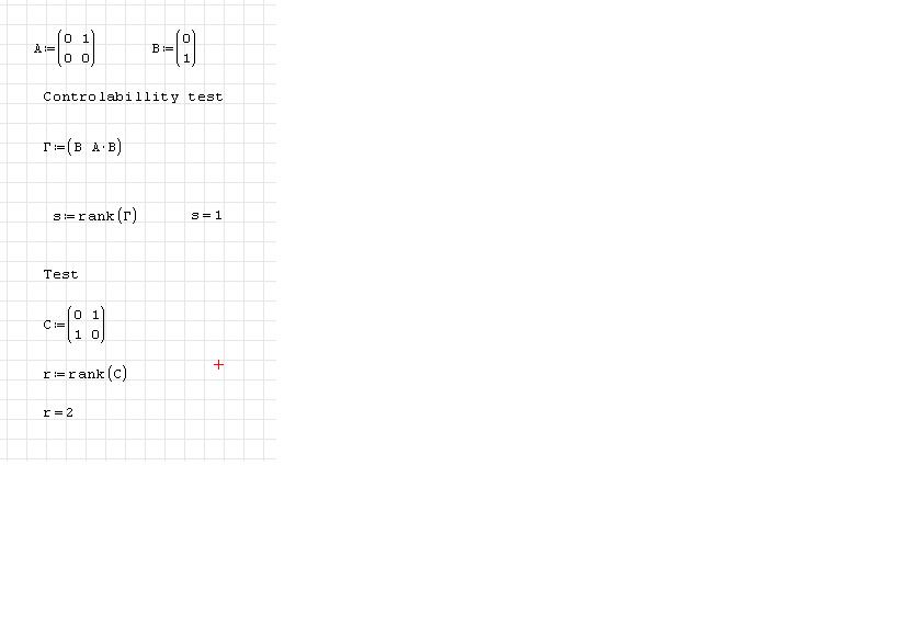

I'm using SMATH for a controls class that I am taking. I am getting bad values for rank of a matrix.
A=[0,1;1,0]
should return a rank of 2
I keep getting a 1

Seems that you defined A as a column vector. Depending on your settings, the comma serves as decimal point or as function argument separator.
type A:mat Enter
This gives you a 2x2 Matrix of placeholders.

You have made an error defining Γ
You need to use the augment() function; without this function you create a nested matrix.
BTW there is a bug because calling directly the rank function when the first matrix element is a nested matrix, a type conversion error appears.
