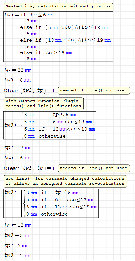

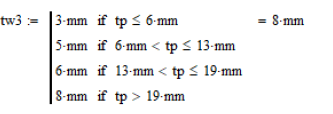

I am new user, need your help how to create this type of equations in Smath

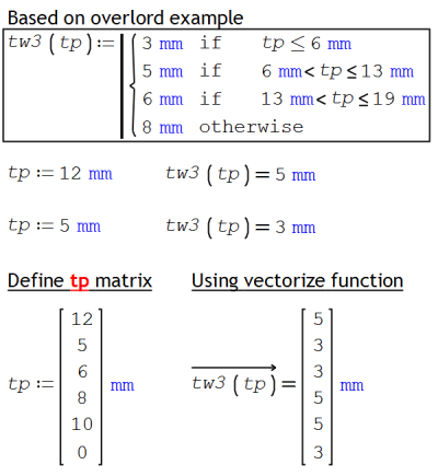

#3 Опубликовано: 15.06.2023 11:42:20
NDTM Amarasekera
NDTM Amarasekera
Based on program by overlord.
if_function_ndtma.sm (27 КиБ) скачан 64 раз(а).

#6 Опубликовано: 16.06.2023 10:25:58
Making it a function as Amarasekera did is much more sensible solution.
