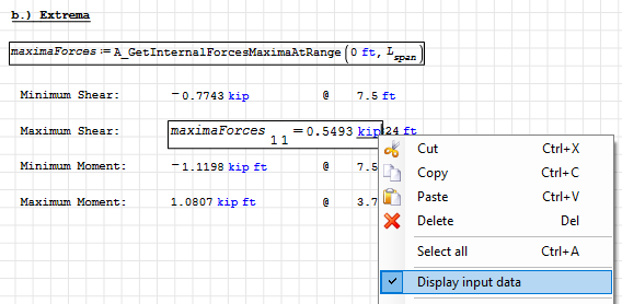

WroteHi JC. Thanks, very useful. Just as very marginal comment, you can improve how to show the extrema results. Instead of write the results, you can automate that in various forms. For example, hiding the input data, like this

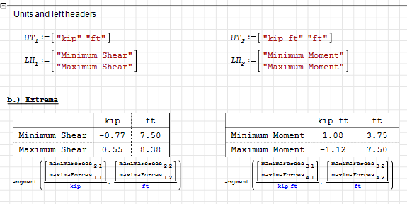

or using the table plugin
Hi Alvaro,
Yeah it is better to put results in table format
