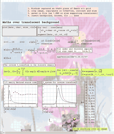

#8 Опубликовано: 15.11.2019 13:23:49
Ruben Sidranski
Ruben Sidranski
I would like to suggest making the "background image" to function like IRFANVIEW "overlay/watermark". I need to make some backgrounds translucent and I cannot find how to do this natively in SMATH. Hoping the IRFAN code is available since it's free too
#9 Опубликовано: 15.11.2019 22:59:12
I would like to suggest making the "background image" to function like IRFANVIEW "overlay/watermark".I need to make some backgrounds translucent and I cannot find how to do this natively in SMATH.
1. Wingrab Capture an Smath work sheet w/o grid
2. SelectTool the all part of the work sheet
........from Smath
4. Insert background [browse from file]
5. fit [it fits both directions]
Now you have a translucent background,
what's the use whereas you are back to native Smath
....... otherwise
insert an RGB image from file, fit to stretch.
If your original has pixels X,Y proportional to
an Smath native pixels X,Y ... the image background
will be nicely zoomed to the full work sheet size
at highest quality similar to IrfanView HD TV quality.
On the other hand, you can't use background to insert
a logo image. For that, create a cartouche.
#10 Опубликовано: 15.11.2019 23:12:45
Ruben Sidranski
Ruben Sidranski
I need to make the image "translucent". I'd like the background feature to allow for making the image translucent. This is doable in Libre/Open Office, IrfanView, etc. They are working on the field and background features, so this would be a nice upgrade.

#12 Опубликовано: 16.11.2019 13:14:03
Like explained before, inserting background is translucent,
i.e: like if it was not here. Then immaterial wrt Smath stuff.
Please let us know if the attached has gray [228, 228, 175]
background ... did the transmission preserved the background ?
Inst_Z Transform.sm (90,39 КиБ) скачан 1532 раз(а).
#13 Опубликовано: 17.11.2019 02:33:13
CBG
CBG
Hello:
I think you have to use an image manipulation program
like Gimp or Krita (both free).
In the example published by Jean, I copied the image to Gimp, lower the opacity to 38% and save the image in PNG format.
I have inserted the saved image as a background.
Inst_Z Transform_Jean.sm (2,97 МиБ) скачан 1672 раз(а).
Carlos
frapuano 17.11.2019 09:04:00, ElSid 18.11.2019 11:57:00
#14 Опубликовано: 17.11.2019 10:31:20
Thanks Carlos, for the fade feature.
That will surely make Elsid more happy.
A nice additional option would be similar to Mathcad:
ordinary background adjustable RGB [Yellow corn, soft gray ...]
Very useful to organize the regions, superb for publishing.
#15 Опубликовано: 17.11.2019 19:18:09
I would like to suggest making the "background image" to function like IRFANVIEW "overlay/watermark".I need to make some backgrounds translucent and I cannot find how to do this natively in SMATH.Hoping the IRFAN code is available since it's free too
Plain background is explained here.
You can have as many personalized background, even different for
each page of the Smath document.
Supplementary detail wrt image:
The native Smath sheet is in close ratio 1 x 1.29 [width*height].
Thus: if you want best image as background, capture in rectangular
ratio close to 1* ~ 1.3. Stretching will preserve this aspect ratio.
WinGrab has the rectangular ratio in pixels.
Inst_Z Transform Plain Background.sm (17,27 КиБ) скачан 1634 раз(а).
#16 Опубликовано: 18.11.2019 12:02:24
Ruben Sidranski
Ruben Sidranski
Hello:
Carlos
Yes! I was looking at "muting" the background image as it was overwhelming the "calculation". IrfanView and OpenOffice call it "translucent" and you called it "opacity"
Jean,
I know you are not a believer of this, but it's for a presentation and having their "logo" is required. Now to PDF and add this calculation to my slides.
#17 Опубликовано: 18.11.2019 16:37:44
Yes!I was looking at "muting" the background image as it was overwhelming the "calculation".IrfanView and OpenOffice call it "translucent" and you called it "opacity"
Jean,
I know you are not a believer of this, but it's for a presentation and having their "logo" is required.Now to PDF and add this calculation to my slides.
Translucent = opacity = Gamma correction are synonymous.
The technical term is Gamma correction [Irfanview, Wingrab, Mathcad].
1. You can have the translucent background in 16777216 colors.
2. You can have the native logo wherever in that translucent work sheet.
3. For convenience: you can manipulate the logo color scheme.
4. Once the document is complete as you wish, make *.PDF
The attached PDF is 1/1 Smath document ... Please: comment.
Cheers ... Jean.
Cadarache.pdf (122,74 КиБ) скачан 966 раз(а).
