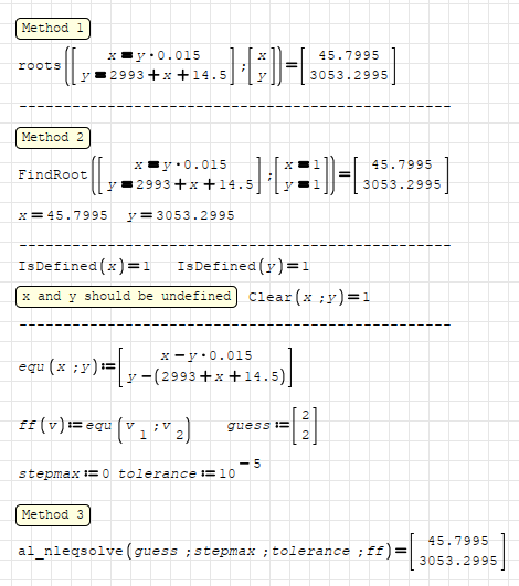

You can't use solve() for nonlinear equations. (more than one unknowns)
You can use roots(), FindRoot() or al_nleqsolve().
Here is your equation solved in various ways.
solvers.sm (10,77 КиБ) скачан 1219 раз(а).

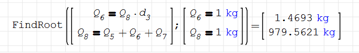

FindRoot is better for my condition, I need units.
Thanks Overlord!

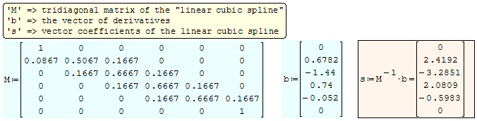

Matrix style is more commonly encountered in Engineering projects.
That example has only one CAS route ... naturally 15 D.
