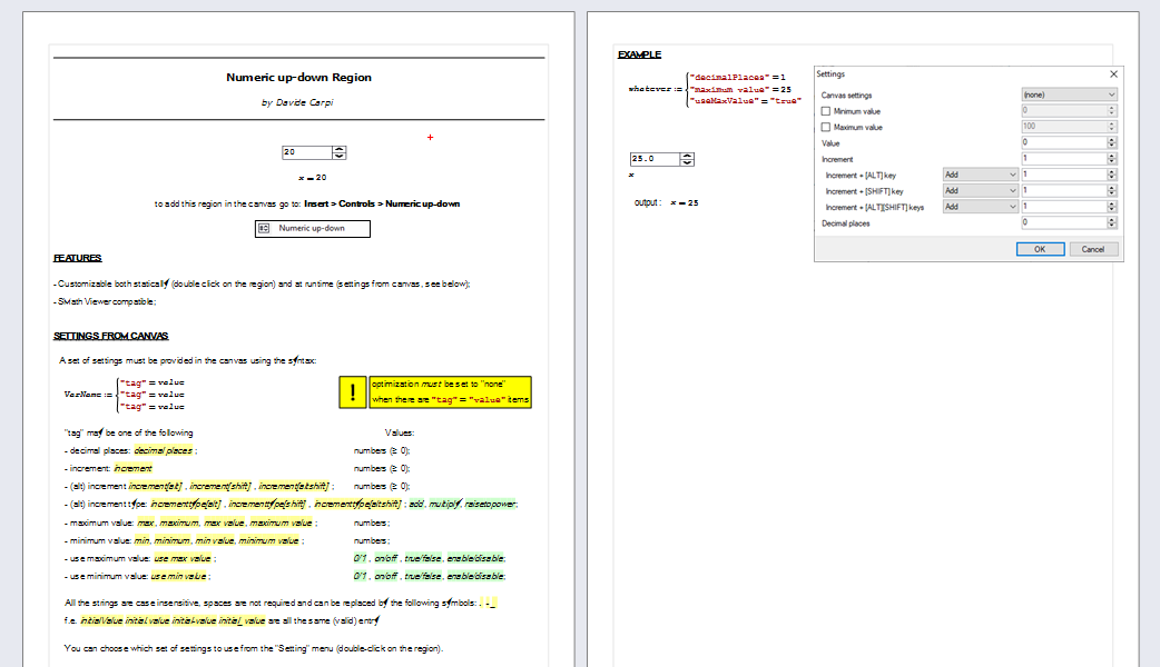

Hello Sergio,
I'm not able to reproduce this behavior. Can you check if it happens to you even in a clean portable build on the same machine?
That's the expected layout:
2021-12-30 12_55_25-SMath Solver - [downloaded_Numeric up-down Region.sm].png

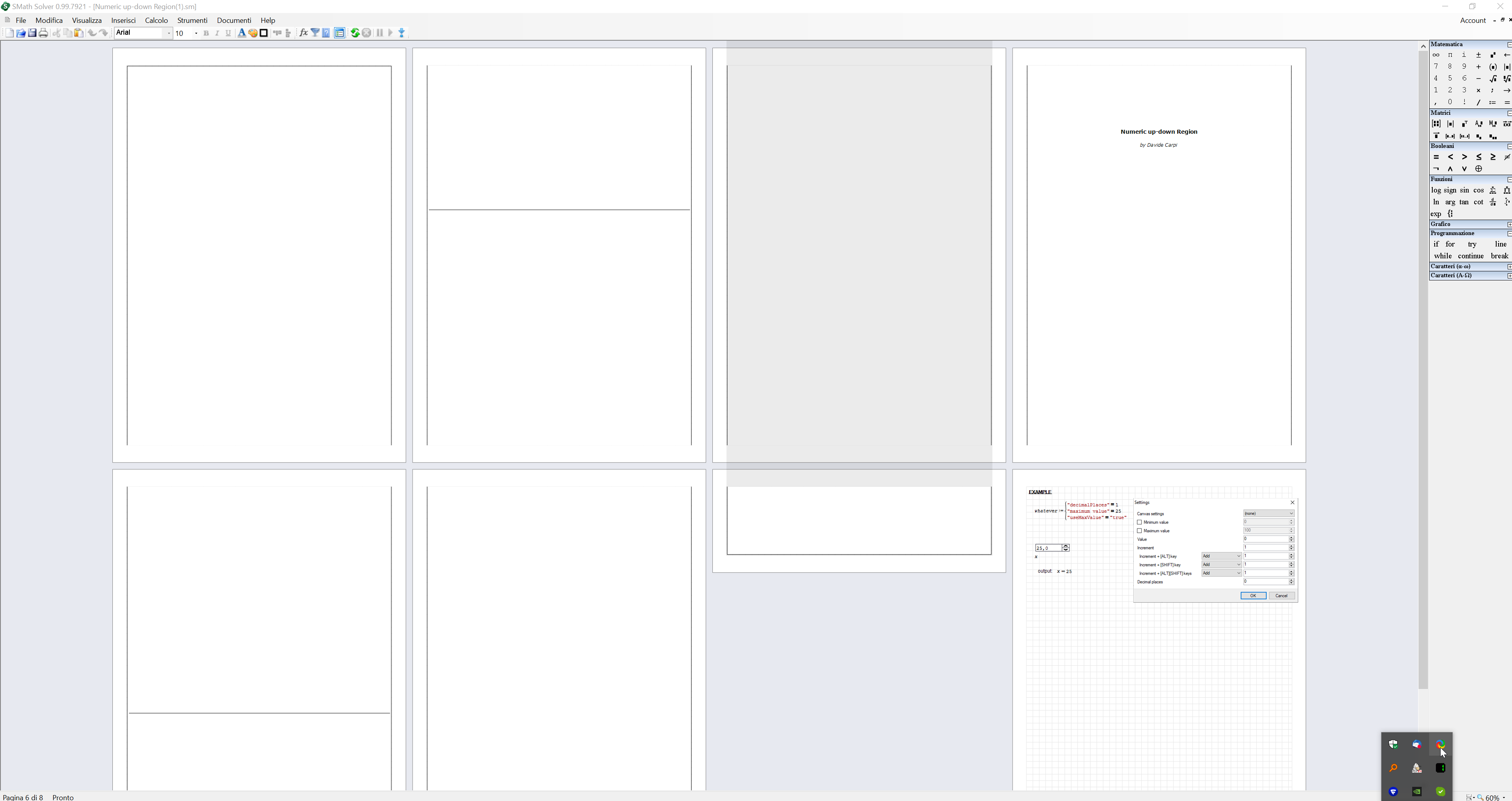

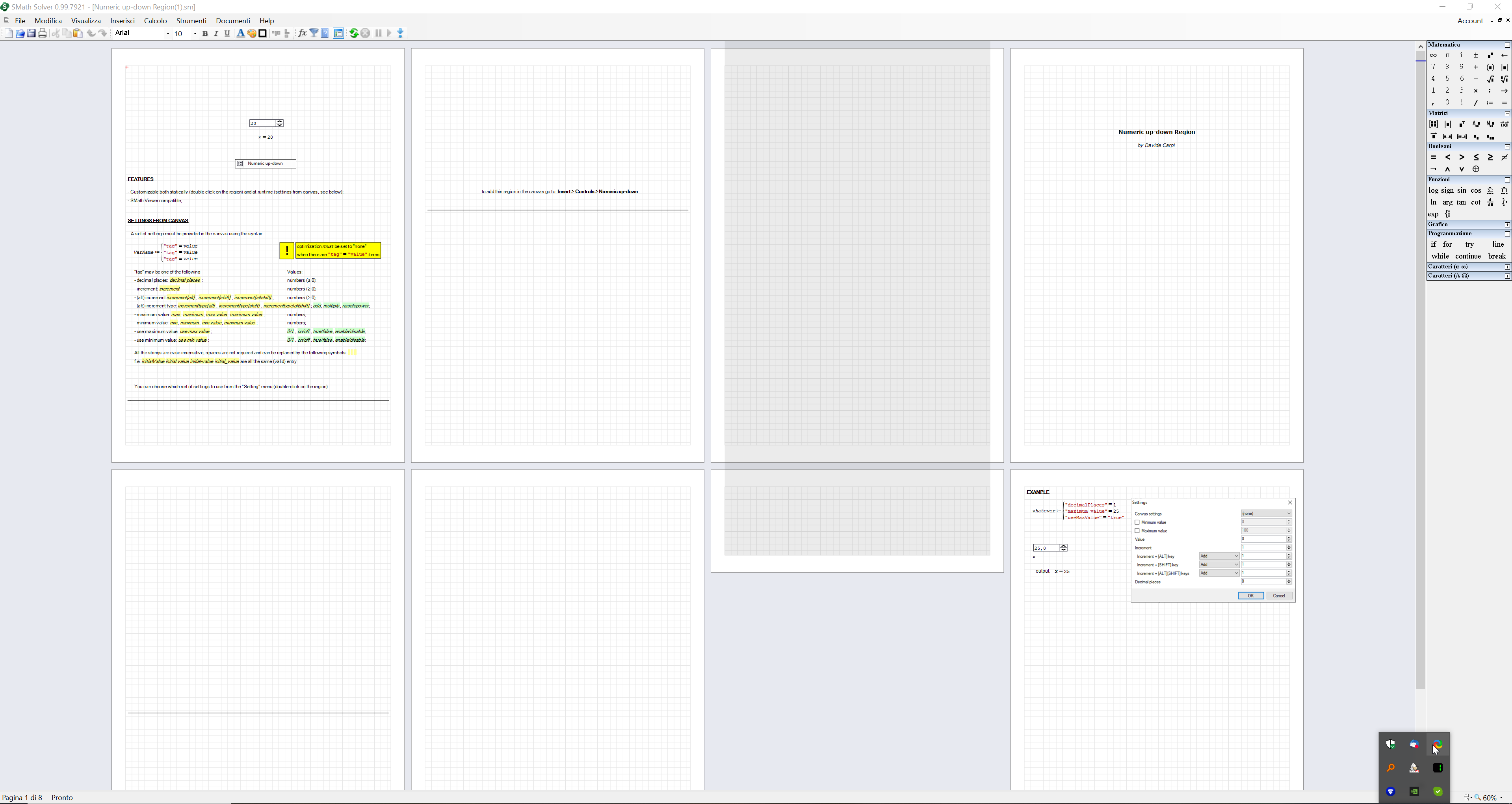

I tried a clean portable version (obviously uploading the file I was asked to install plugins: Numeric Up-Down and Writer) by detecting the same problem. I attach the first image is how the file is presented at the opening and the second image is what happens by clicking on the canvas.
Показать спойлер
Показать спойлер

This happens to me when a document has a font that doesn't my PC has.
