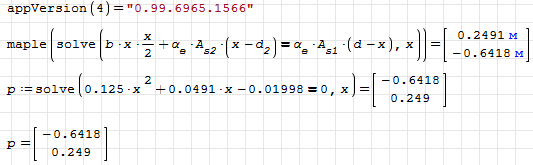

#2 Опубликовано: 27.01.2019 15:05:54
Alternatively you can try maple() function from the Maple Tools extension.
Davide Carpi 28.01.2019 05:53:00

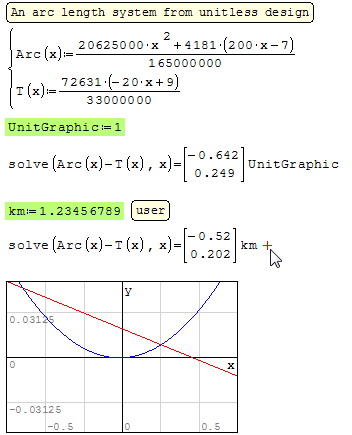

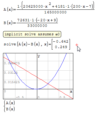

#3 Опубликовано: 27.01.2019 16:14:40
Hello, maybe someone could help
1. recast the functions unitless
2. plot
3. solve implicit in this case.

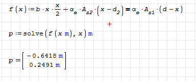

Hi. You need to handle units in the SMath solve function. Here it's a way.
NDTM Amarasekera 28.01.2019 07:13:00, sergio 28.01.2019 06:54:00, Davide Carpi 28.01.2019 05:53:00, frapuano 28.01.2019 12:57:00

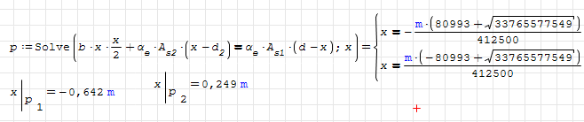

#5 Опубликовано: 28.01.2019 10:29:14
Solve() from the Maxima plugin can handle units directly (symbolic solver)
2019-01-28 14_26_49-SMath Studio - [Gelzbetonines%20konstrukcijos%20ilinkio%20skaiciavimas.sm_].png
