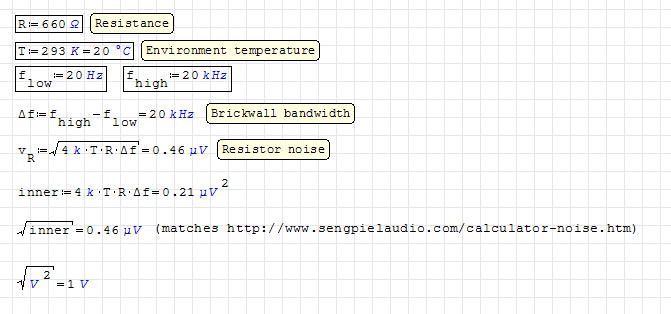

I had a worksheet that worked in the past, but now it doesn't, saying "operation cannot be performed with units", because it's sqrt(V^2)? But if I break it up into two steps it works:
resistor noise fail.sm (6,87 КиБ) скачан 1348 раз(а).

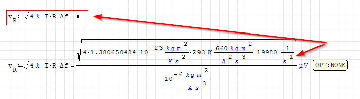

I've already seen this bug, sometimes comes to light...
when the SMath engine output unitary exponents on units, square root fails.
Refreshing the worksheet alternately works/doesn't works.
[EDIT] Added in the BTS: SS-177
