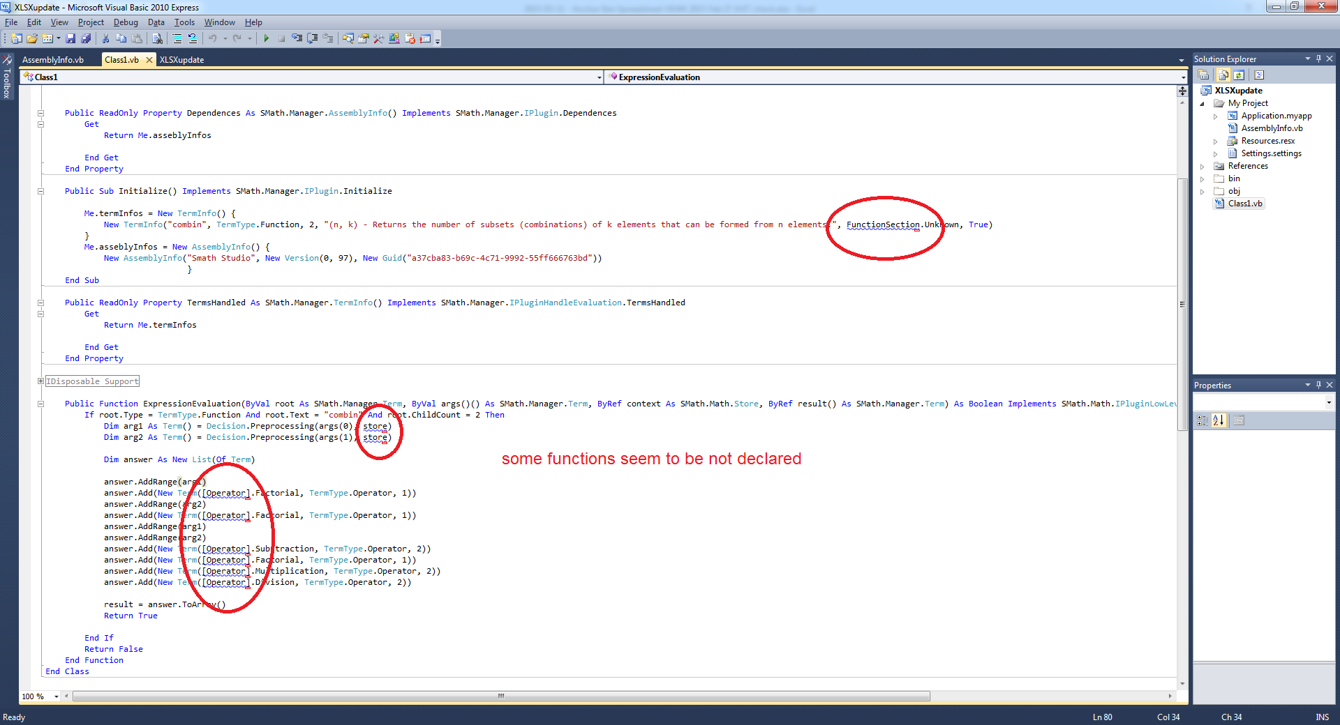

I have not reached a glorious conclusion yet, however even now I can notice something to be incorrect (see screenshot).
Could someone please point out what I am doing wrong? Please keep in mind that I have never attempted to piece few lines of code together before and hence might miss obvious things. I am attaching my project folder.

The function argument is ByRef context As SMath.Math.Store -> change it into ByRef store As SMath.Math.Store (or change the store variables into context)
use Operators instead of Operator

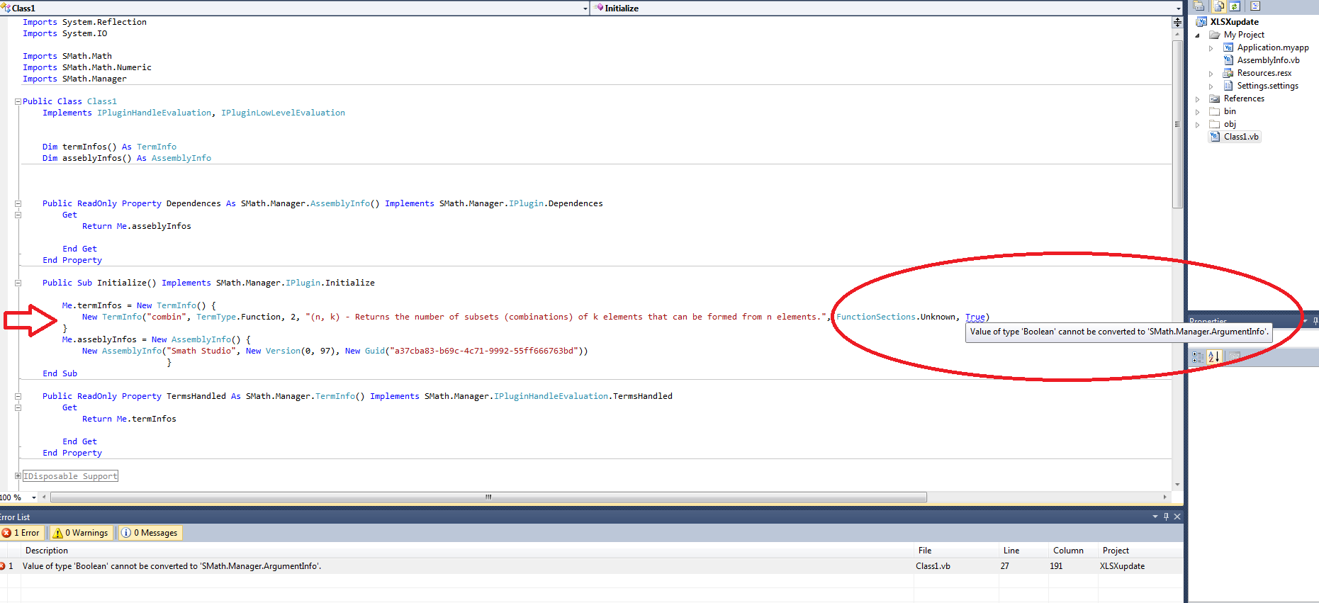

Also, back to plugin tutorial..Now how about this one:
Thank you!!
#4 Опубликовано: 16.03.2015 14:31:01

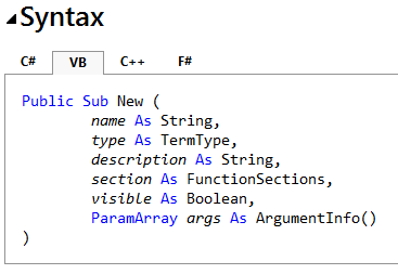

You have to delete the third argument (old syntax, I guess)
New TermInfo("combin", TermType.Function, "(n, k) ‐ Returns the number of subsets (combinations) of k elements that can be formed from n elements.", FunctionSection.Unknown, True)
As for the processing, you have to use the low-level evaluation or the numeric/symbolic evaluation. Some examples are in several plugins (f.e. something is in the wrapper of the GPC wrapper)
