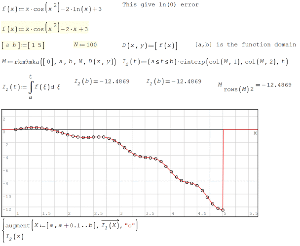

Hi. I can't reproduce this in SMath.
Вячеслав Мезенцев 30.11.2018 03:25:00, Radovan Omorjan 30.11.2018 05:06:00

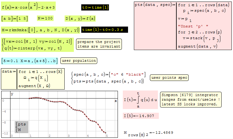

#2 Опубликовано: 29.11.2018 23:48:00
1/1 in Smath 6179, proof: the snippet.
Cheers Alvaro
Integrate with ode solver.sm (29,07 КиБ) скачан 1248 раз(а).

#5 Опубликовано: 30.11.2018 02:31:22
You may not be able to implement the Mathcad bloc Given/ODEsolve.
Hi Jean. Actually not, just the solver, without the given.
I found how to call the odesolver, with D(x,y)=[f(x)].
This method is much more faster than the direct integration.
But remains the ln(0) error, which seems to be a bug in the odesolvers, because zero isn't in the domain range.
Integrate with ode solver.sm (10,17 КиБ) скачан 1186 раз(а).

#6 Опубликовано: 30.11.2018 03:35:52
The zero point is used to determine the dimension of the vector D(t,x) at runtime (D(0, x0)). The size of the system must be determined for the further operation of the numerical algorithm. It seems that it would be correct to substitute the beginning of the interval. I will try to change this. Also, if possible, I will support the one-dimensional case.

#8 Опубликовано: 30.11.2018 12:29:42
Buenos dias Alvaro !
ln(0) was introduced in Mathcad 11 soon after release via update [from recollection]
There is more in the attached, specially wrt parametric D(,,,).
ODE 0_Model General.sm (29,47 КиБ) скачан 1222 раз(а).

#10 Опубликовано: 30.11.2018 15:36:38
... refreshed version wrt explore all solvers.
ODE 0_Model General.sm (38,44 КиБ) скачан 1188 раз(а).
